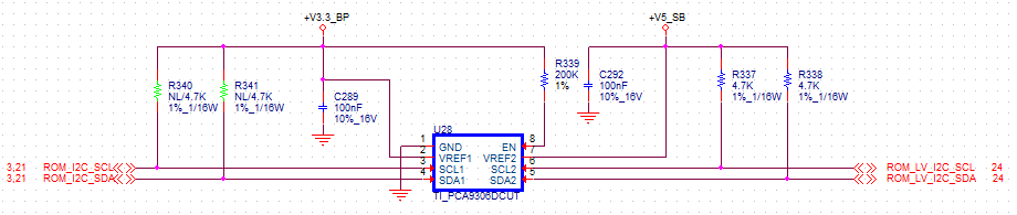

Have any risk if we connect EN pin to Vref1 (3.3v) through 200k resistor?
Thanks for your reply.
  • Shu-Cheng,
    Your schematic is incorrect. The device will not opporate correctly. Please see
    and note that EN and VREF2 are first shorted together, then pulled to supply through a 200k resistor. This is CRITICAL that EN and VREF2 are connected first before 200k to supply.
