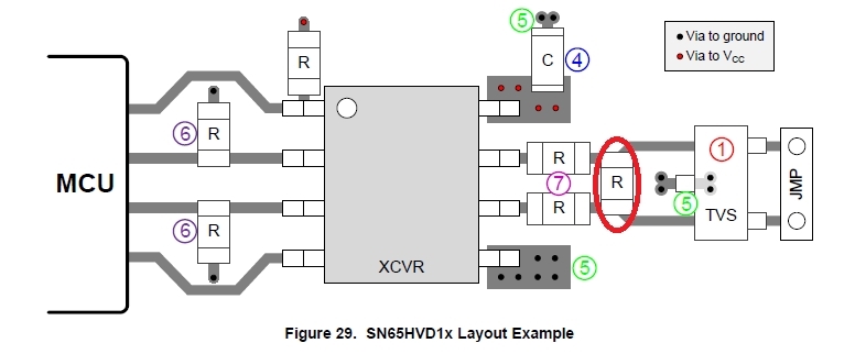

1. In case of implementing ESD protection with referring the figure in datasheet below, where is the best place to implement the termination resister? Could you share its reason also?

  • 1. As shown in figure 29, the termination resistor should be between the series resistors and the TVS.
    (The series resistors form a voltage divider together with the termination resistor.)

    1. Clemens is right in his answer to you about the placement of the termination resistor. Ideally you would place the termination resistors as close to the transceiver bus pins as possible to minimize reflections because from the termination resistor to the bus pins is essentially an unterminated stub. The transient protection components should be placed close to the connector to minimize the distance a transient can travel on your board. Any series resistors can be place anywhere along the trace length.

  • Hi Clemens, Hi Michael,
    Thank you very much for your prompt reply.
    1. Let me clarify the termination resister in the figure 29. It's the red circled resister in the figure below. Correct?

  • Hi Ikoma,
    Yes the resistor that you circle is the termination resistor. RS-485 uses 120 ohm differential termination resistors at either end of the bus to ensure communication. Here is are a few links that may help your customer understand some of the details of RS-485 better:
