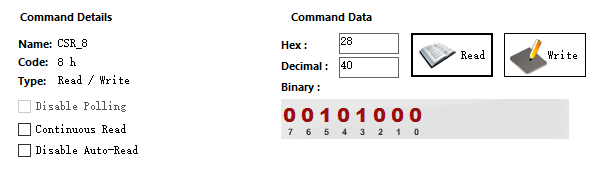

    3. The difference is the precense of VBUS. VBUS should be provided before or at leaset at the same time the Ra pins, in this case you should be able to read 0x08=2A.

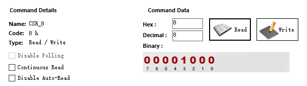

    James: In my test, I short CC1 and CC1. Then I connects a small board with a 1kΩ Ra on the CC pin, by a type-C cable. If VBUS is provided before or at lease at the same time the Ra pins, the reading of Register 0x08 is always 28 (see first figure). If VBUS is provided after the Ra pins, the reading of Register 0x08 is always 08 (see second figure).  I cannot find 0x08=2A. it is possibly a bug? Can you please check it?

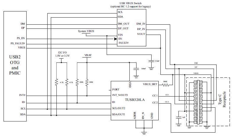

    1. I have question on the EN_N.  In the datasheet page 3,  it is stated in Pin Function stable that both EN_N (TUSB320L) and EN(TUSB320H) must be held low at least for 50 ms after VDD has reached its valid voltage level. Should it be “EN must be held LOW at least for 50 ms after VDD has reached its valid voltage level. EN_N must be held HIGH at least for 50 ms after VDD has reached its valid voltage level.”? You said my assumption is right.
    However, I check the figure in datasheet page 21. The EN_N is always pulled down to ground.  Can you please verify which way is correct?

    James: Today I used two 1K pull downs connected together to GND and there is no change on the test results. The Register 0x08 = 0x28, rather than 0x2A. Can you please share your test result?
