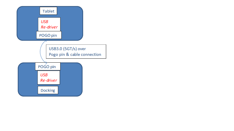

  1. Tablet上 USB3.0 use cable/FPC & pogo pin connect to Docking station for IO extender ,
currently plan to use single channel re-driver (2* TUSB501 or 2* TUSB551)put 2 devices  in (Tx on Tablet;Rx on dock)
for above application, may you suggest Re-driver use single channel or dual channel(TUSB551 or 501)? where is the best location we can place?
