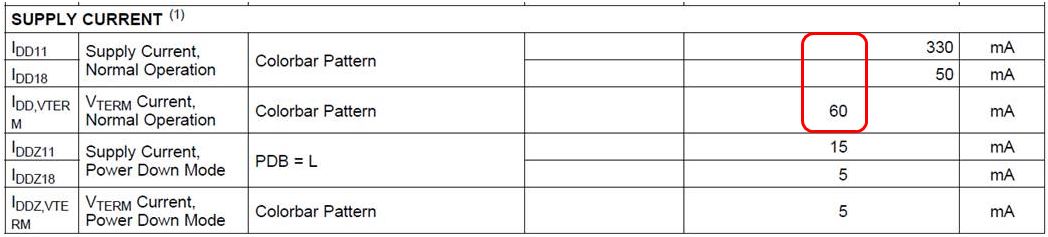

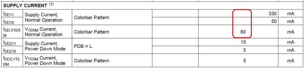

DS90UB949 power consumption
Could you let me know 949 typical current as shown below table?
I can’t find out any other datasheet.
  • Hello Luke,
    Typical value for IDD11 above (colorbar pattern) is 21mA. Typical value for IDD18 above (colorbar pattern) is 228mA. Keep in mind that these typical numbers are only there for reference and that a customer's system design/conditions (i.e. temperature, supply voltage, etc.) might be quite different from our validation setup and therefore typical customer measurements for these power rails might yield different results than those specified. The maximum values specified however, are guaranteed by bench characterization that a customer's system will not exceed these in production.
    -Sean
  • Sean
    I think there are typo.
    You have stated that "Typical value for IDD11 above (colorbar pattern) is 21mA. Typical value for IDD18 above (colorbar pattern) is 228mA. "
    But i think this is correct. "Typical value for IDD11 above (colorbar pattern) is 228mA. Typical value for IDD18 above (colorbar pattern) is 21mA. "
    Please clarify.
