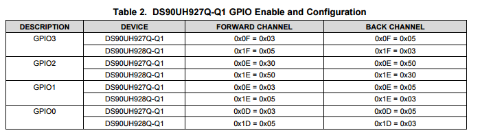

Dear Sir,
We use the IMX6 platform.
Below is our flow.
IMX6 GPIO(output) ->DS90UB927 GPIO1/GPIO0(forward channel input, local ) -> DS90UB928 GPIO1/GPIO0(forward channel output, remote ) -> LCD backlit.
Could you let us know how to setting it?
