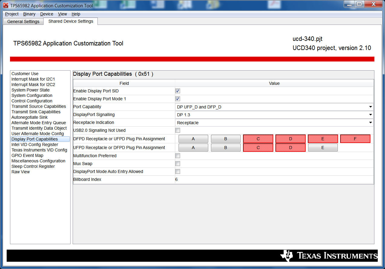

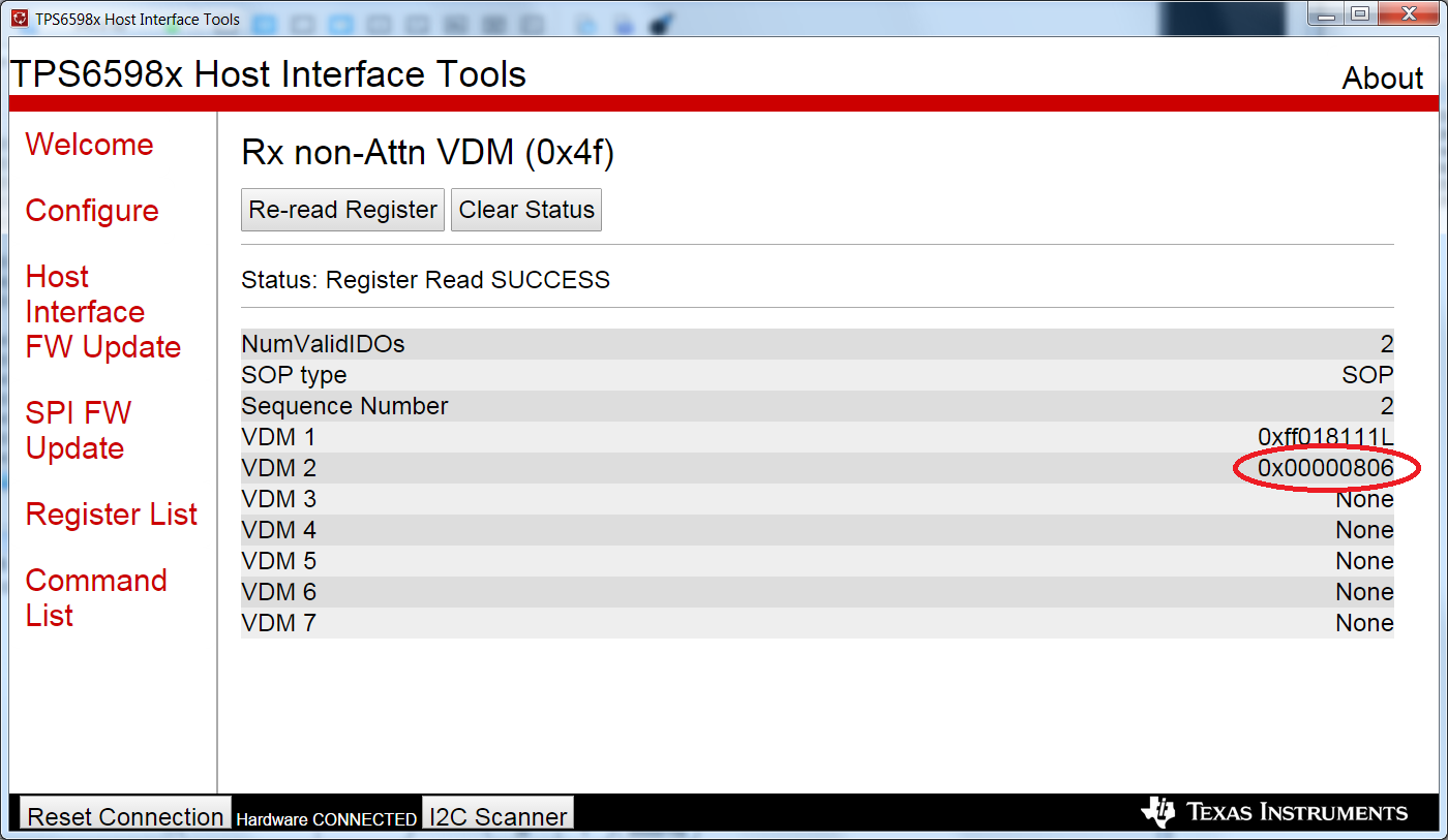

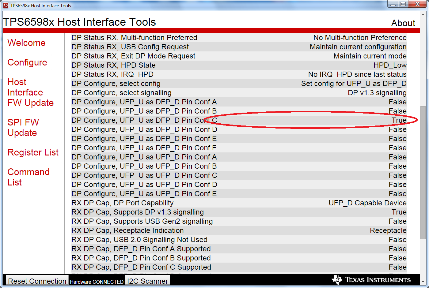

I met following issue, when TPS65982 is in DP Alt Mode as DP Sink, content of DP Configure Message is always zero. DP_Configure message is captured by USB PD Analyzer, but is not written in the the register.
When TPS65982 is DP Source, DP Configure Message contains valid data.
Is this a bug? Are there any other way to retrieve current DP Alt Mode configuration?
