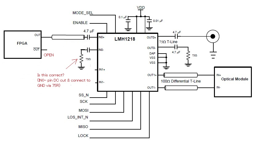

  • Hi Sir,
    Thank you for your support.
    At last, I want to confirm interface circuit about between FPGA and LMH1218.
    The LMH1218 input is differential end and FPGA output is single end.
    So, IN0- pin of LMH1218 connect to GND via 75R with DC cut.
    Is this correct?
  • Hi Kuo,

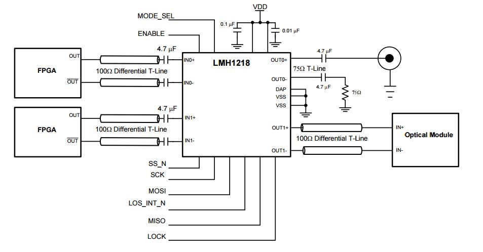

    This does not sound correct. It seems like the FPGA's output is already a cable driver. Can you provide more information about the FPGA  output that you are trying to interface with our LMH1218?
    The LMH1218 is expected a 100-ohm differential signal at its input. The LMH1218 output will drive a 75-ohm coax cable. Because the LMH1218 is internally terminated on the input and output, there will be impedance discontinuity if you attempt to interface a 75-ohm output from the FPGA to the LMH1218 input.
    Typically, the FPGA will output a 100-ohm differential signal, which is connected through a 4.7uF AC coupling cap to IN0+/-, such as below:
    Only the LMH1218 output OUT0/- should interface to 75-ohm media.
