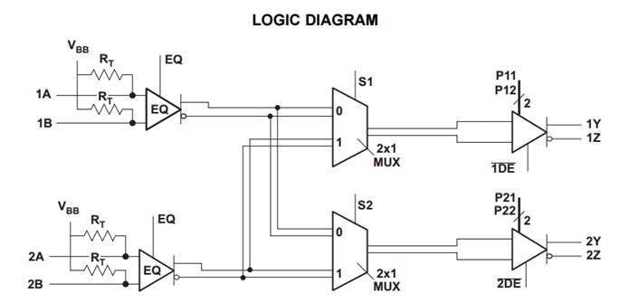

3. At switch Definitions, what is mean includes cross points and other configurations like 4:2 or 2:4??
Switch
General term that includes MUX and DEMUX but also includes cross points and other configurations like 4:2 or 2:4

    3. Crosspoints, muxes, and demuxes all involve a switch that allows you to select either which input or which output the signal is routed to in the chip. This is an example of a crosspoint diagram:
