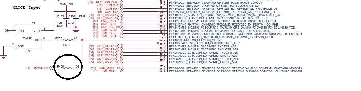

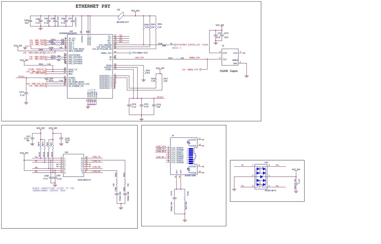

I'm interfacing DP83848I with Kinetis K70 microcontroller. PHY is bootstrapped to RMII mode. With the cable connected I'm getting a valid link status.
When I try to ping my board from PC I'm getting timeouts. Once in a while I can see that the ping succeeds. I tried reading the PHY registers and I see that FCSCNT and RXERCNT is set.
Attaching the register values that I read from PHY.

Also I'm attaching a screenshot from the hardware schematics relevant to Ethernet.
Please help me in finding the solution for this problem.
