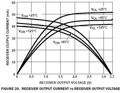

Hi dear supporting team,
do you have the current VS voltage curve like below for sn65hvd75 receiver? i.e we comment  8mA max current, what's the voltage should it be?  tks a lot!
  • Hi Vera,
    We unfortunately do not have this curve measured for this device, but I can help clarify the VOH/VOL specs. These voltages were tested under the maximum recommended load current of 8 mA. Therefore, when the output current is 8 mA the high-level output will typically be 0.3 V below VCC but could be as low as 2.4 V (e.g., when VCC is at 3 V and device with worst-case process tolerance is operated at a temperature extreme). Similarly, the low-level output will typically be 0.2 V when the load current is 8 mA, but can be as high as 0.4 V.
    I hope this is all clear, and please let me know if you have any other questions.
