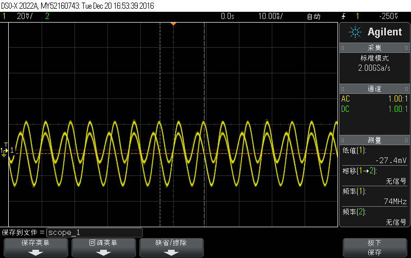

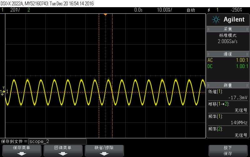

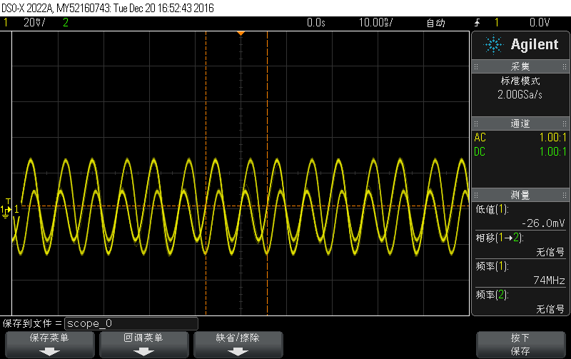

Occasionally, the output of 148.35MHz port (Pin 23 & 24) fails after power up, by channce of around 3/20. The waveform measured then looks wierd as below snapshot (P/N). However, the 148.5MHz port always works fine.
Currently, there is no any configuration for LMH1983. It always boots up with default values, expecting to lock to the input reference (F/V/H and they could be all tied to low or some non-supported format) and generate apporpriate 148.5MHz clock and 148.35MHz clock. What could be the reason for this? And should I have to configure some registers to recover it?
The below snapshots are good 148.35MHz, bad 148.35MHz of P port, bad 148.35MHz of N port. Thank you.

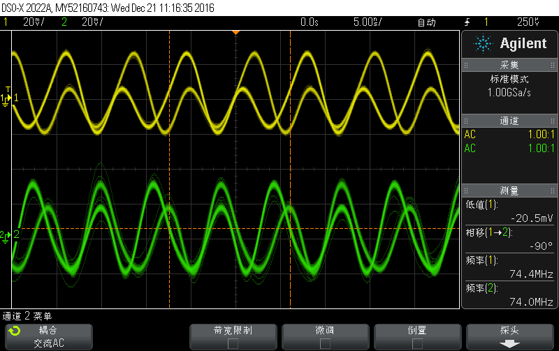

    BTW, the below shapshot is the P&N ports of 148.35MHz clock at a time.
    Thanks again.

    I noticed in the datasheet, it states
    8.3.11.1 TOF3 Initialization Set Up
    Under some circumstances, it is possible for an LMH1983 to power up in an anomalous state in which the output
    of PLL3 exhibits a large amount of cycle-to-cycle jitter. A simple register write after power up will prevent the
    device from remaining in this state. Writing to Register 0x13[5:4] = 10'b to force Always Align Mode ensures that
    the device will not exhibit poor duty cycle performance on CLKout3.
    I added an I2C host and configure this register with value "10b". It could recover the bad output and makes the chip work appropriately. Therefore, I think I have to add this host although it is a bit annoying. It should be much greater if the LMH1983 could be improved on this site in future, because actually I don't need any other configuration for this chip.
