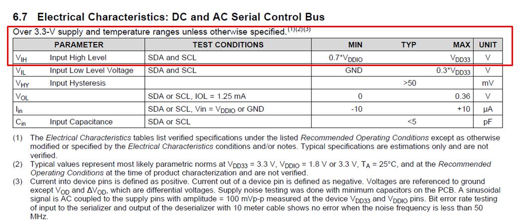

It is very confusing about DS90UB927 I2C pull-up voltage.
Pin description said PU voltage should be 3.3V(VDD33), but Input High Level min is depend on VDDIO which can be 3.3V or 1.8V in Electrical Characteristic.
Could you clarify I2C PU Voltage can be possible 1.8V?
