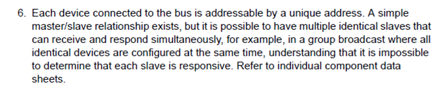

  • Hello James,
    The I2C spec calls out that each slave have a unique address, unless you are setup to do a broadcast.  If there is more than one device with the same address on the bus than the Master will not know which device responded with the "Ack".   Both may pull down on the SDA line to perform the "ACK".  The point is the master won't know which one it is.  I have put some excerpts from the I2C specifications to elaborate.
    -Francis Houde
