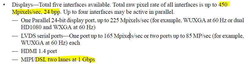

Hi Joel,
Thanks for detail explanation. Is there the table or the information that shows the DSI clock speed and number of lanes versus the DP resolution? From the below description I got from the customer, the system should be able to support 1920x1080p(60Hz) resolution of eDP panel with 2 lanes DSI, right? Please advised. Thanks again for your help!!
