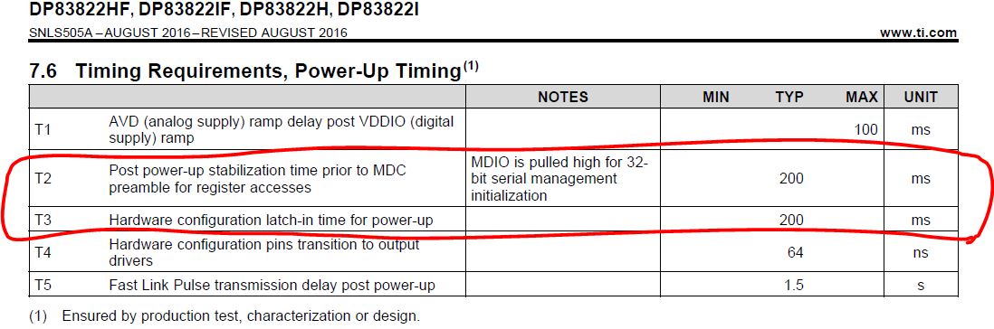

We are working with one customer on one new PLC IO modules project looking at our DP83822H.

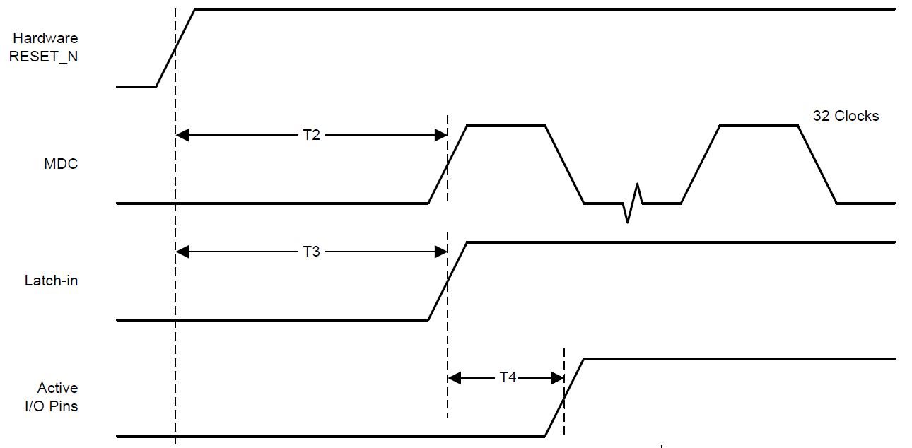

Customer design call for a feature that need to support quick connect which require the IO module to power up and establish an active IO connection with the controller (PLC) within 300ms. With this, they reckon the communication hardware subsystem should not be consuming more than 200ms of the timing.

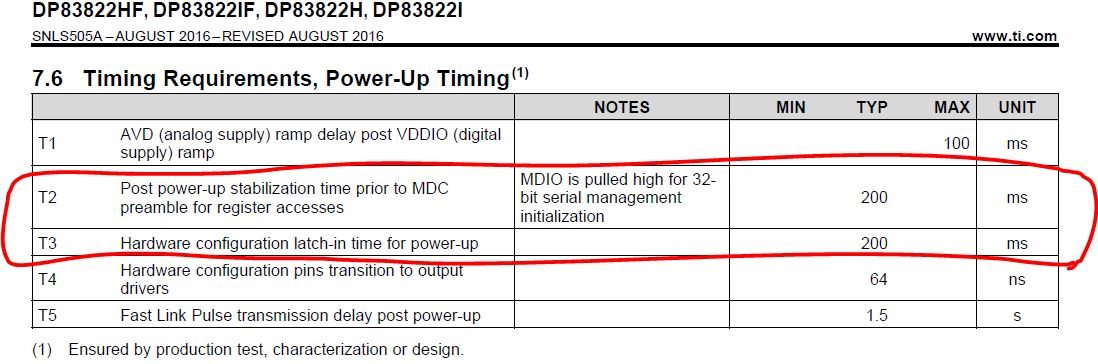

With reference to page 10 of DP83822H data sheet (7.6 Power-Up Timing), extracted as below. The typical hardware power up timing for T2 and T3 is 200ms. Customer asked if we have more data for this parameter to share ? They are interested in the max value.
