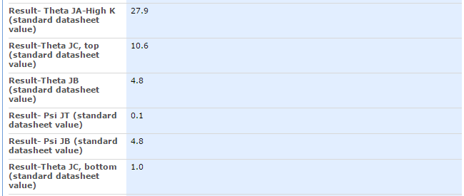

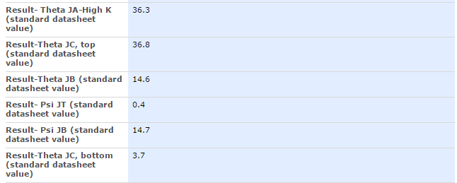

What is the junction to board thermal resistances of the products LMH0340 and LMH0341? There is a thermal pad under the device and I think it is used as a cooler. The thermal resistance of junction to ambient is mentioned on the datasheet but there is no info about junction to board. Can anybody help me?
