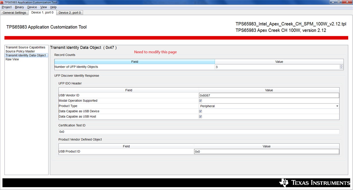

Hi Sir,
Currently we survey with TPS65983, but have some question need you help.
1. What is the difference about 100W and 75W? looks description is same.
2.
3.
  • Wen Yung,
    A1: As the name suggests, both the configurations present different source PDOs
    A2: 'Number of Connected Devices' allows users to save unique configurations for up to two devices in a single image to flash simultaneously. 'String Table' allows the user to input the necessary billboard information for manufacturer and product. If a project is not selected, this section will not be loaded.
    A3: This information will be sent as a response to 'Discover Identity' message - Refer host-interface TRM for more details on this register
    -/Praneet
