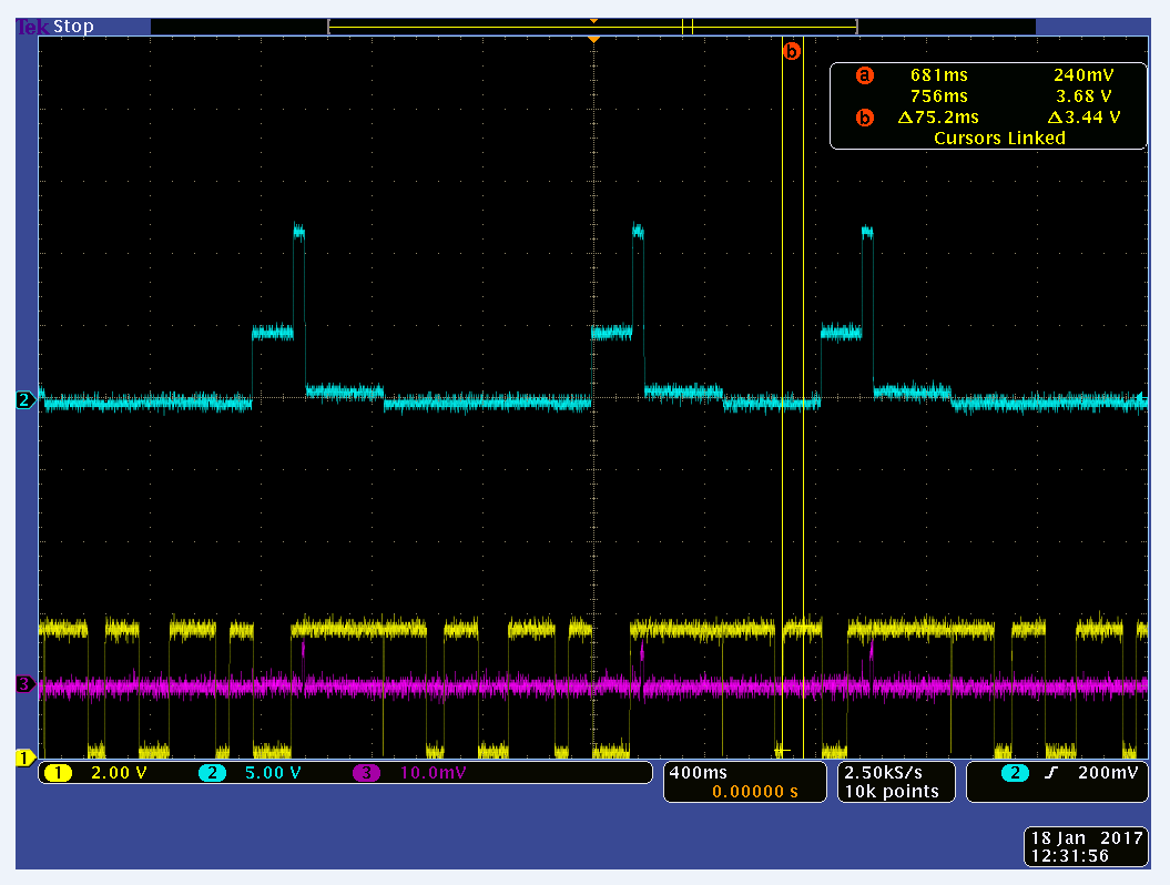

I'm using two TPS65982 evm, one as sink, the other one as source.
I took off J6, J7 is not soldered, and J4 is not present on my sink. I use J5 3V3 Connector as power supply input for the tps (3.3V generated by external generator).
When I plug the source to my sink (12V or 5V) my TPS source keeps on crashing until I take off 3.3V.
The waveform below illustrates the VBUS behavior (the blue one).
Is there something I forgot to set?
Thanks in advance for your help,
Daniel
  • Daniel,
    Can you please help w/ below information to investigate further?
    - Do you see a stable 12V contract if 3.3V is taken off from the sink?
    - Pl share the configuration files for both the source and sink?
    - Pl share the PD logs, preferably captured by Lecroy?
