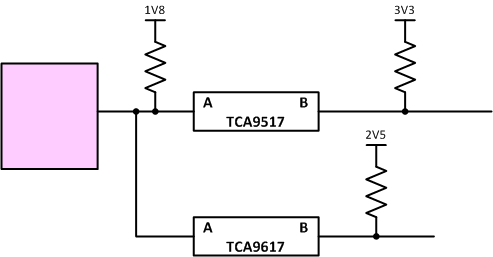

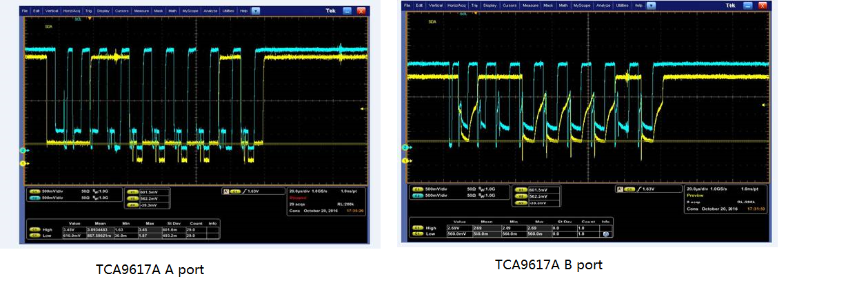

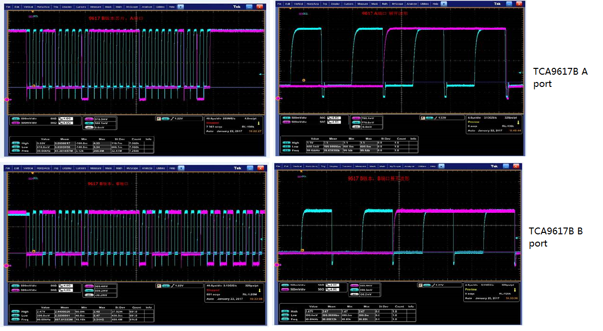

3. Below is my customer's application, you can focus on TCA9617 application, VCCA > VCCB. They also use TCA9617A and TCA9617B to do the same test, for TCA9617A, the waveform is abnormal and the communication also have some error, but for TCA9617B, the waveform looks good and the communication is also good. You can check the waveform below. Do you think the wavefroms for TCA9617A and TCA9617B are reasonable? From customer's test, it seems that this application can work, what's your comments about the application for TCA9617B?

    3. I am not sure what is happening during the transactions as seen in your post, but it is likely that it is an overhead issue.
    I may have a solution for you depending on the speed your customer is trying to achieve. The TCA9517A does not have the Vcca<Vccb requirement, but it cannot support more than 400 kHz.  I saw you guys were using 100 kHz (at least that was what I could figure out from fuzzy waveforms).  It is also pin to pin compatible.
    Why are they using two buffers in series? They could have easily did this in parallel and wouldn’t have had this issue. It also compounds delays in the system.
    I am a bit unsure of what they are trying to accomplish with this setup.  They could potentially also use this configuration but it would require new layout and more system analysis.
    Do they hare a large capacitive load?  What frequency are they running at?  Let me know.
