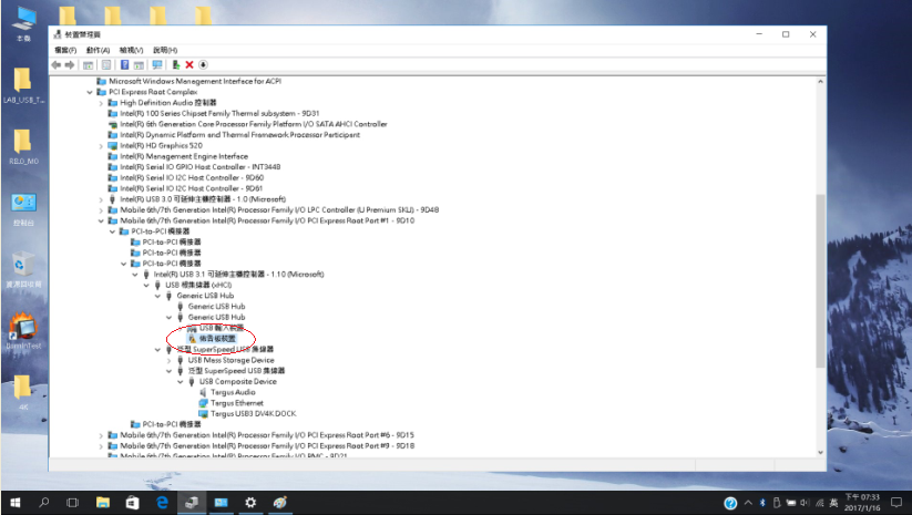

4. another question about new version product has five PDO (relative PD success), but has un-know device in Device Manager.
   I have double confirm, is TPS65982. this project has no DP ALT mode.
   Could you help check our config setting has error? thanks.
