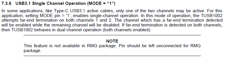

Hi Team,
My customer considers to use TUSB1002 for single channel operation.
Could you tell me the difference of power consumption between single channel operation and dual channel operation?
In addition, please let me know if you have application consideration for using single channel operation except the following content.
(datasheet Page 16)
