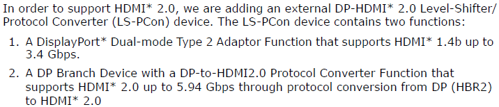

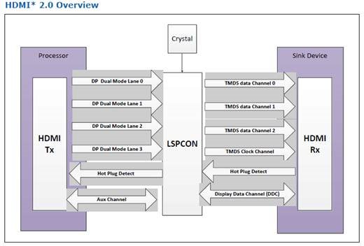

One of our customers asks me whether or not SN65DP159 is LS-PCon device? The description of LSPCon is below:
If not, do we have any IC that supports LS-Pcon? Also, if DP159 is not LS-PCon device, is it because DP159 only has first function but not second function mentioned in the LS-Pcon description I uploaded? Please correct me if I am wrong. Thanks for your time and support!!
