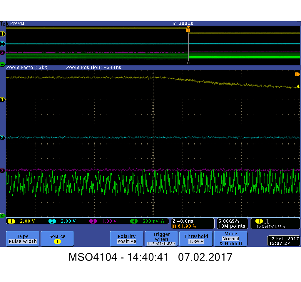

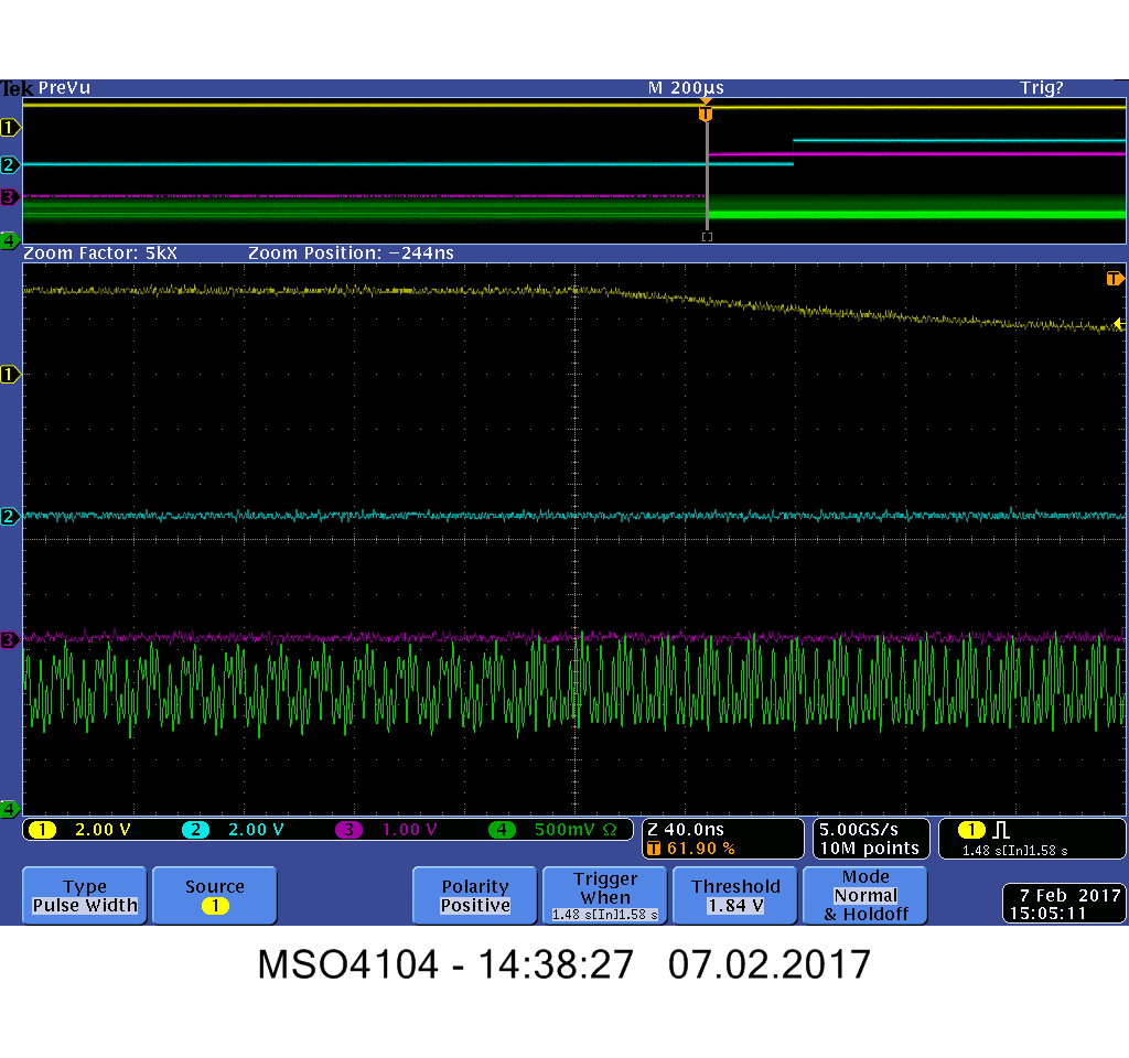

  • Hi Lee
    Changing the system to a slower clock is very difficult and expensive (e.g. changing oscillators).
    Unfortunately, our scope is a bit slow (1GHz / 5GS/s). Anyhow I tried to measure this event with our scope and our active probe (1.5GHz). I cannot see any differences between the good and the error case. I know this is a but vague with my scope but it gives at least a hint.
    Description of scope channels:
    CH1: Deserializer ROUT0 (pin 45)
    CH3: Deserializer /LOCK (pin 63)
    CH4: Deserializer RIN+ (pin 7)
    CH2: not of interest for this question
    Good case:
    Error case:
    Maybe the power supply has a disruption, when the FPGA is reset. How sensitive is the PLL to power supply disruptions?
    Thanks and Regards,
    Markus
  • I can see that there is a pattern change miday across the scope waveforms.  The probing is showing a relatively large amount of noise on the signal.  Would it be possible to zoom in to a "Sync" waveform to help get a better look?  Set the horizontal scale to ~ 2ns/division.  This may just be a signal integrity issue
    The PLL should not be overly sensitive as the device was in "lock".  Since it came out of "lock" the likely cause is the received data being corrupted in a way which caused it to lose the Start/Stop transition.
    Lee

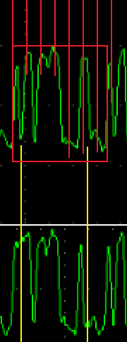

  • Markus,
    I worked to align the LVDS data from before and after ROUT0 changes.
    I see what looks like two bits going from "High" to "Low" just before the Lock is lost by the deserializer.  I have marked them with yellow lines.
    The rex box is one 20-bit dataword wide (it includes the start and stop bits).  The red vertical lines are 3 - bit widths wide.
    Can you describe which bit (should be one of the yellow lines) indicates ROUT0?
    Lee
  • Lee,
    Thank you for the drawing. The two transmitted 20-bit data words (incl. start and stop bit in bold) are as follows:
    1: 1 1 1 1 0 1 1 1 1 1 0 0 0 0 1 0 0 0 0 0
    2: 1 0 1 1 0 1 1 1 1 1 0 0 0 0 1 1 0 0 0 0
    Bit 0 changes from high to low and bit 14 changes from low to high. On your drawing the left yellow line indicates bit 0 (ROUT0) and the right yellow line indicates bit 14. The reason why two Bit values change vice-versa is to keep the data stream dc-balanced. The dc-balancing is needed because we us an optical transceiver.
    I am pretty sure, that the data stream at the input of the SerDes is correct. I believe there is another root cause why the PLL lock is lost. I suspect an issue with the power supply.
    Markus

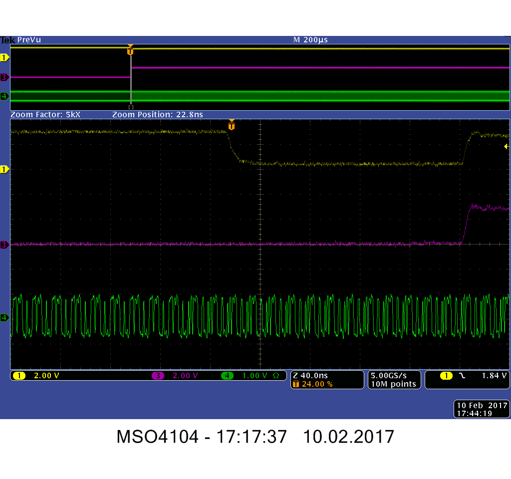

  • Hello Lee,
    I believe that a small spike on the input LOCAL_LE (pin 79) is the root cause of the problem. The LOCAL_LE input is connected to the FPGA and when the FPGA is reset there is a small spike. I believe that this spike activates the transmitter loopback mode for a short time and the Deserializer sometimes loses the lock. I do not understand why it does not lose the lock always although the spike is always there. Additionaly, it is interesting that there is sometimes a pulse on ROUT0 although the lock is not lost.
    Do you think it is plausible that this spike can enable the loopback mode? Do you think it make sense that the PLL can lose the lock when switching to the loopback mode? How does the logic in the chip switch from normal to loopback mode? Does it make a difference, at what point in time LOCAL_LE changes? Is LOCAL_LE asynchronous to the input clock?
    Markus
    Descprition of Scope inputs:
    CH1. ROUT0 output
    CH3: /LOCK output
    CH4: LOCAL_LE input
    Deserializer loses lock:
    Deserializer does not lose lock:
    There is a short pulse on ROUT but the Deserializer does not lose lock:
  • Hi Markus,
    It is possible the glitch will disrupt the LV18 operation.  Does the LV18 lose lock if you disconnect the FPGA and let the internal LV18 pull-down hold the LOCAL_LE pin Low?
    Lee
