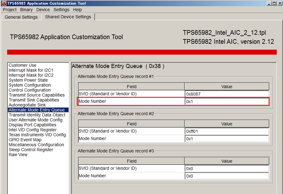

TPS65982: Alternate Mode Entry Queue (0x38)
Guru 29720 points
Part Number: TPS65982
Hi Team,
What is "Mode Number" in Alternate Mode Entry Queue (0x38)?
I would like to know how to decide the value.
Yaita / Japan disty
  • Hi Yaita-san,
    The mode number for SVID 0x8087 and 0xFF01 will always be 0x1. If you were using the user alternate mode you can have multiple modes that you can assign mode numbers to (ex. 0x1, 0x2, 0x3 for 3 different modes) in the context of the user SVID.
