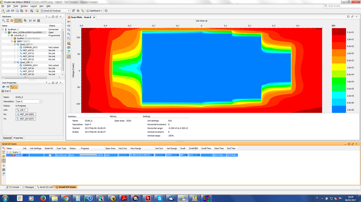

I'm in trouble with the DS125DF1610 device, this device is part of a complex design in which is also present a DS125MB203 chip.
I'm trying to configure del following loopback path toward an onboard FPGA:
FPGA (PRBS source) -> (3inch) -> DS100MB203 -> (7inch) -> (CH0 A RX) DS125DF1610 ->(CH0 A TX)DS125DF1610 -> (7inch) -> DS100MB203 -> (3inch) -> FPGA (PRBS ck)
The final rate will be 12.5G CPRI, to make the setup easy I tryed a 4.9G CPRI rate, in this conditions I'm able to perform the PRBS check without problem, but I'm not able to see the CDR lock bit 4 in reg 0x78 up. The PRBS don't see any error, instead the DS125DF1610 reports a DFE_EQ_ERROR_NO_LOCK.
I'm not able to overcome this error also changing the adaptation, someone can help me?
If I try the same configuration with an upper rate 9.8 I'm not able to perform any test, and the eye of incoming signal is totaly corrupted (instead at 4.9 seems perfect).

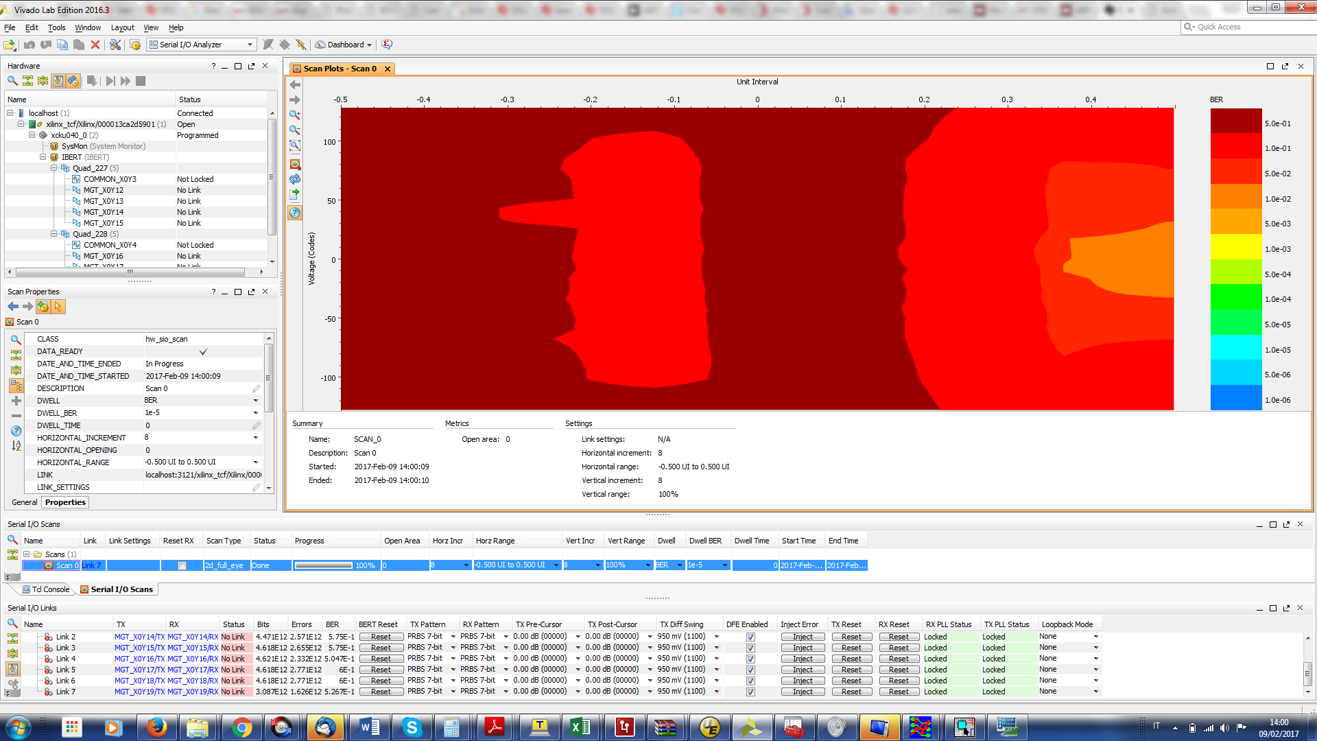

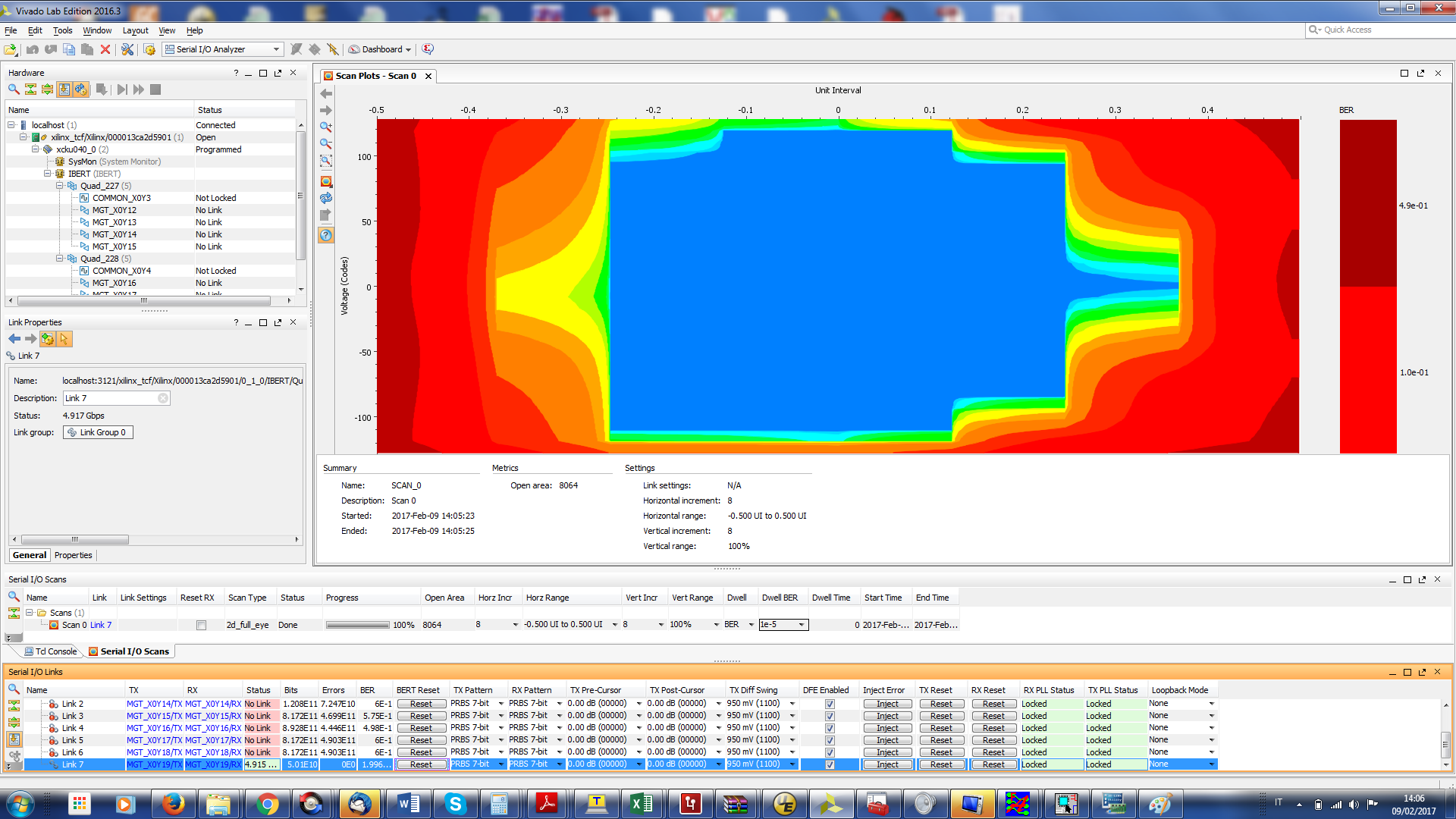

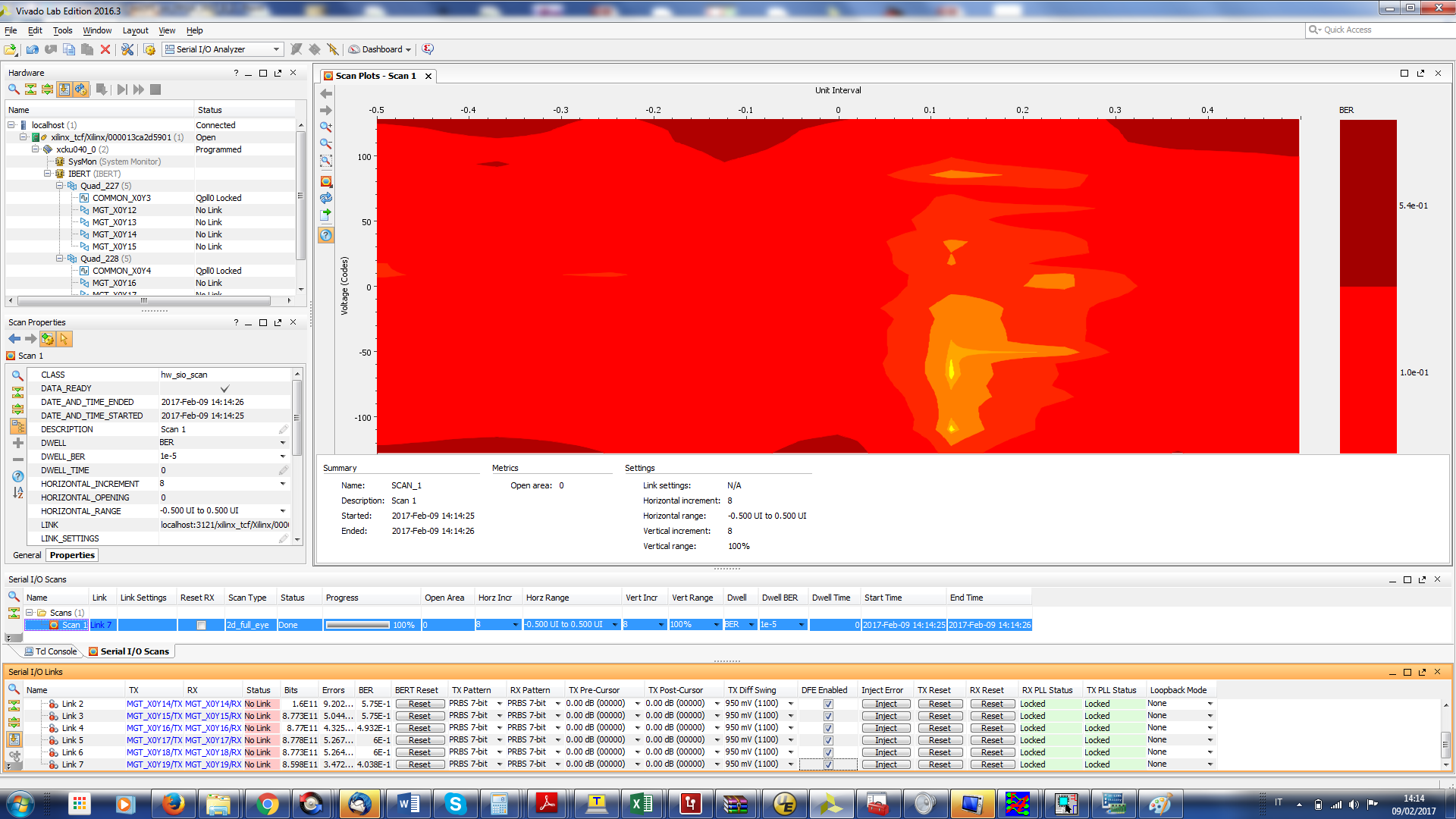

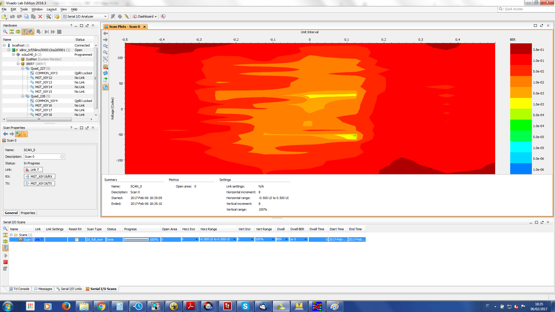

  •   Hi Lee,
    Nothing good at higher rate ..see the eyes!

  • Hi Lee,
    I have done other tests and now I'm able to Lock on 4.9G but persist the problems with the 9.8 not able to lock.
    Moreover can you confirm that is right your suggestion

  •  Hi Lee,
    Here you can find 4G9 eye with and without DFE on FPGA, then I have tried 6G1 without success and the eys is very strange, seems that the retimed data are not at the right frequency (I set the rate REG[2F]=0x96) the last eye is at 9G8.
    Thanks Maxx
  • Hi Lee, I have posted the eye traces, but the moderator has not yet approved the my post! Also at 6G1 the doesn't work !
  • Thanks Maxx
    The eye diagrams are very strange.  Do the system FPGA Tx's have equalization enabled?
    I will keep looking through the data.
    Lee
  • All the Tx equalization parameters are shown on the link line (link7).
    maxx
