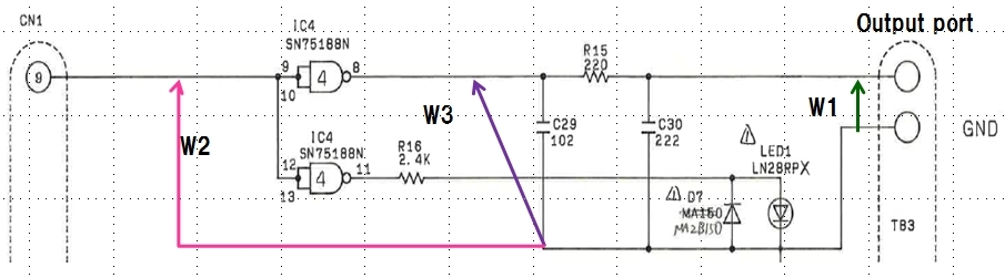

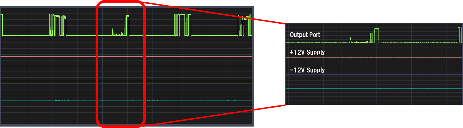

We are facing the noise issue of SN75188N output under the operation in 50℃ to 55℃.
Input signal : 5V, 9600bps
Power Supply : +/- 12V
W1: Output Port
W2: Input of SN75188N
W3: Output of SN75188N
However, there was no noise under the operation in normal temperature (around 25℃).
And the there was no problem about supply voltage when the noise occurred.
What do you think cause is?
Could you please give us your view?
BestRegards
  • Could you please give more details about the loading condition, like the component value/model? Is there any load at output port? Is the noise periodic? Is it related to the supply variation? I'll follow up with you. Thanks!
  • Hi Hao
    Thank you for your support.
    -component value/model
    C29:1nF, C30:2.2nF, R15:220ohm
    A programmable controller is connected to output port.
    -Is noise periodic?
    No.  The noise seems to occur randomly.
    - Is it related to the supply variation?
    No.  The supply doesn't seem to be varied and not related to noise.
    BestRegards
  • What I meant was if the noise is related to the voltage value of the supply.
    What's the input impedance of the controller?
    Can you also provide rise/fall time of normal operation? In datasheet, RL of rs232 device is between 3k~7kOhm. Thanks!
