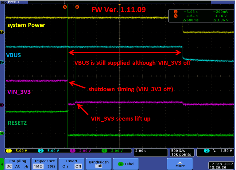

    >Are you sure the device is operating as a source and that VIN_3V3 is disconnected?
    Yes, please refer to the following waveform.
    It shows VBUS still supplied from TPS65982(PP_5V0) although powering off VIN_3V3 under Firmware version 1.11.9 (from TPS6598X-CONFIG ver 2.12.1 )
    My customer also found LDO_3V3 still outputs 3.3V after powering off VIN_3V3.
    note: system power (include PP_5V0) is off 10 second later from shutdown in his system.

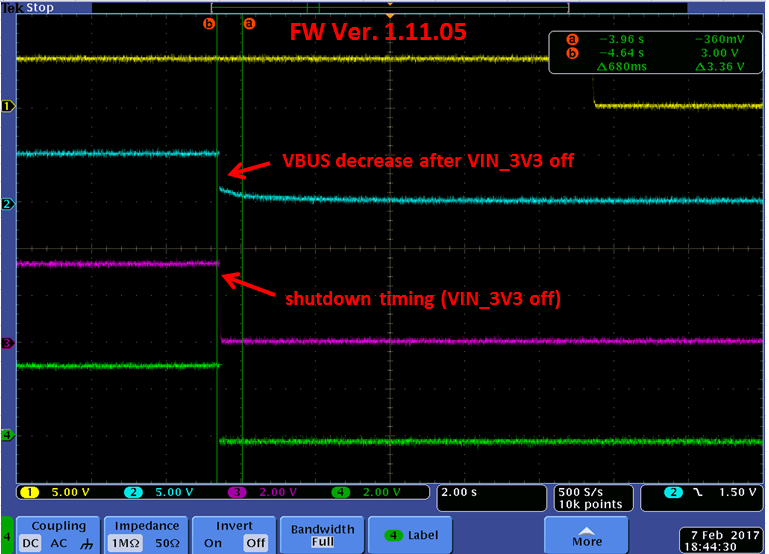

    On the other hand, my customer evaluated same test with same firmware configuration under Firmware version 1.11.5 (from TPS6598X-CONFIG ver 2.10).
    It shows differnt result as the following.
    VBUS (and LDO_3V3) decreased to 0V after powering off VIN_3V3 in this case.
    I believe latter result is normal feature and concern there is bug in Firmware version 1.11.9 (TPS6598X-CONFIG ver 2.12.1 ).
    Could you confirm this issue in TI?
