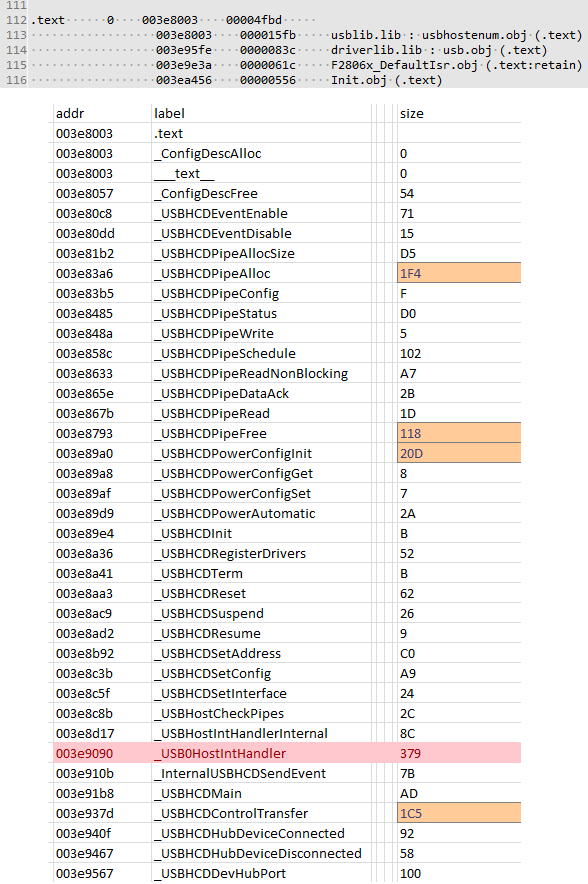

Recently, I have updated the USB library from v135 to v151. This helped to reduce the failure rate but resulted in new issues. The library sources v135 were originally copied locally and the files were modified to relocate the USB functions to a "run from ram" section. To do it in a cleaner way with v151, I now preferred to link the .lib file directly to the project to ease future updates. Doing so resulted in the USB functions not being in RAM anymore and a memory footprint of the USB library which seems 3 times larger ... so I cannot afford to place all of it in RAM anymore ...
Initially I thought the linker was including unused content erroneously. See this thread for details. With some help of George Mock, I was able to determine that the module related to HOST mode functionalities seems to be included in the final binary output while I only intend to perform DEVICE mode operations. Below is the analysis of some .map content when not trying to relocate to ram :
map content
I know my predecessor already solved problems similar to the ones I'm having by running the library from RAM. See here. So I really need to be able to do this (It is also much longer to bootload ... :/)
* How can I configure the library or modify my code such that the HOST related functionalities and any other undesired modules are not included in the binary output ?
* Which modules are most important regarding USB lower layer protocol and should preferably be relocated in RAM if I cannot fit all of it as previously ? (I think to relocate first usbdenum.obj and usbdhandler.obj)

    The linker should not be linking in unused code. To try to eliminate this, make sure you have optimizations turned on, at least -O2 level.
