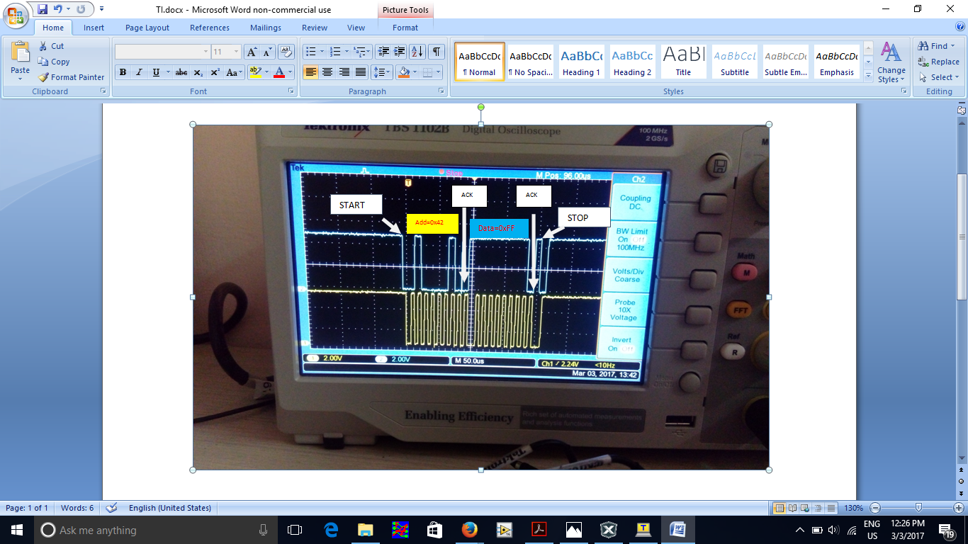

  • Hi Francis Houde,
    Attached Oscilloscope image. In this, for first 8 clocks, I am sending address 0x44(include write bit 0). Then, in the 9th clock, slave responds with low. For next  8 clocks, I am sending data 0x01. Then slave responds with 0.

  • Hi Francis Houde,
    Please find the attached image with remarks so that you can easily get in to further queries.

  • Hi Muthu,
    Sorry for the delay - Francis is out of the office right now, so I am taking a look at this for him.

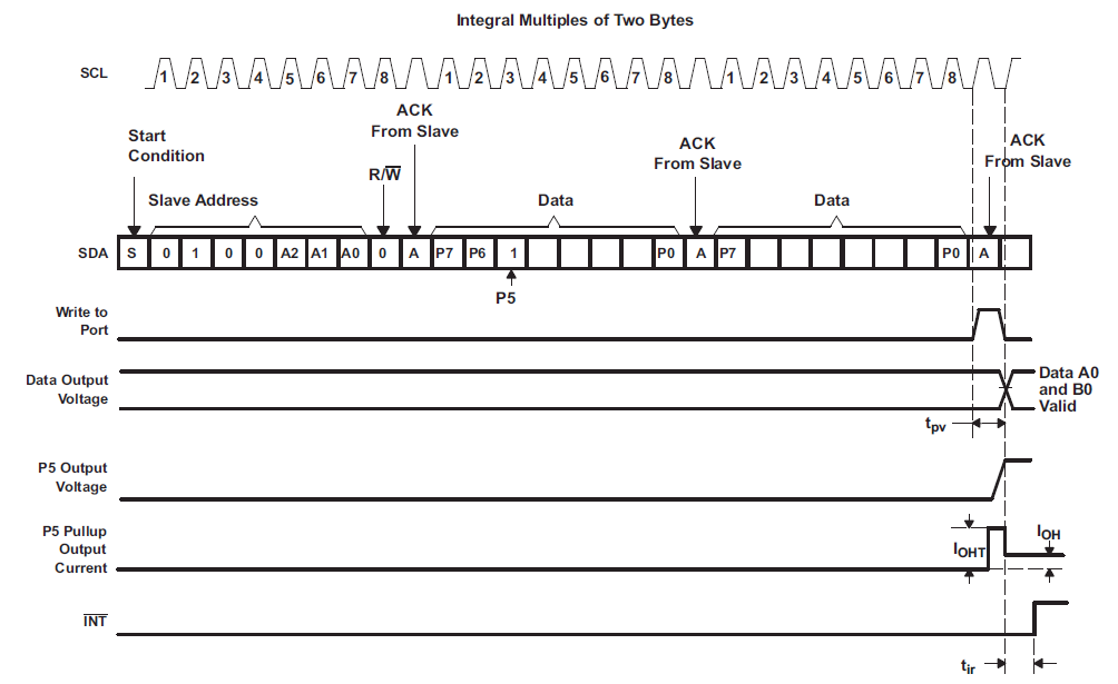

    There are a couple things I wanted to point out based on the waveform captures you provided. I see on your schematic that you have all three address lines pulled low; if this is the case, then the device address that you should use for a "write" operation is 0x40. Also, the datasheet indicates that two bytes of data transfer are required for full device programming (see Figure 12 as well as the note on the figure that Francis referenced in his earlier post). I'd recommend adding another eight cycles of 0xFF data following the ACK in your waveforms; the P[7:0] outputs should then be valid following the third ACK.

  • Hi Muthu,
    In the image Francis copied above, there are three 8-bit transactions. The first communicates a slave address and indicates whether the operation is a read or write. The second two each define the P[7:0] values. I realize this is a little strange given that there are only 8 port values to assign, but could you try sending the P[7:0] values twice after the address? The figure shows the configured values not actually being transferred from the internal shift register to the output ports until this second data byte (third byte total if you include the address) is written and acknowledged.
