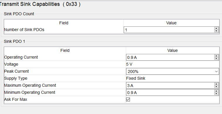

We check the sink capability setting, there is no problem as following pic. The detail setting as in the file.
20170211.pjt

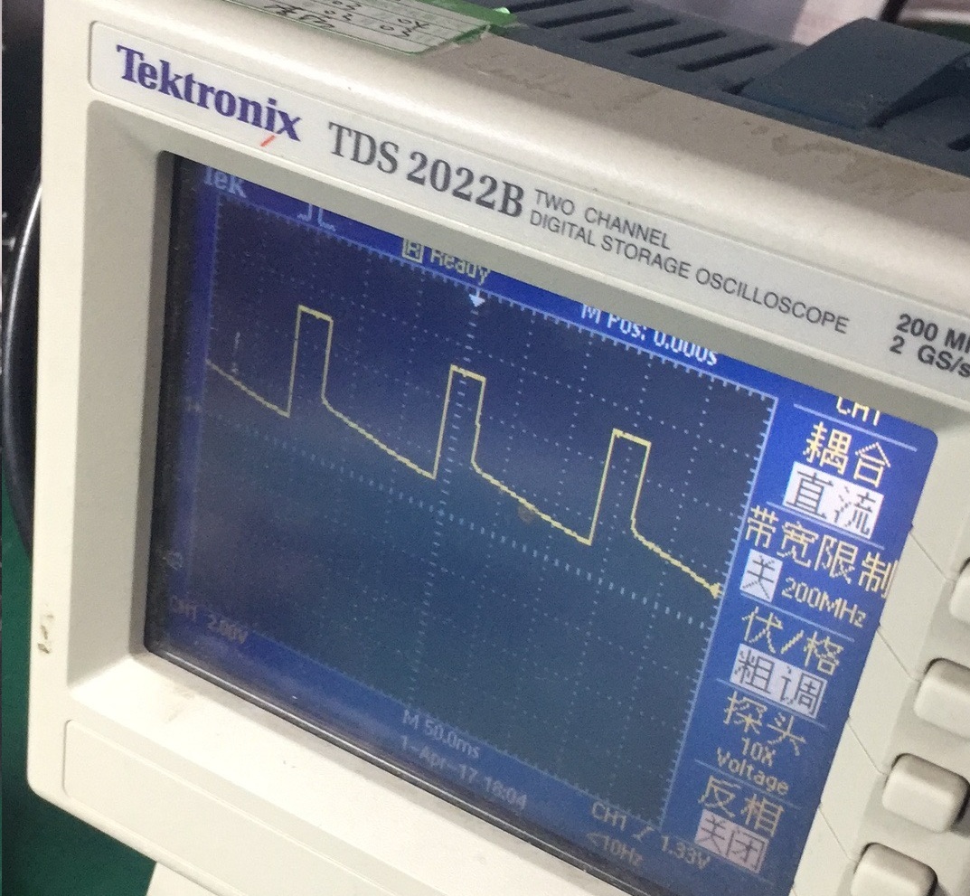

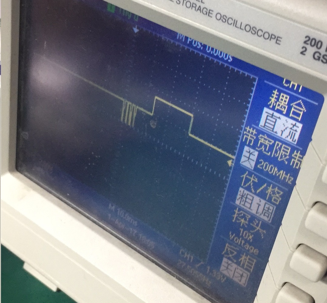

We also test the voltage for the CC, as followed:
1. Firstly, when Docking connect with the PC, unplug the adapter, the CC voltage: one is 0V, another is 1.7V. Docking work normal.
2. Then, plug the adapter, one is 5V, another is 1.7V. Docking work normal.
3. Then, unplug the adapter, one is 0V, another is 1.7V. There is no 5V at the VBUS. Docking can't work.
Customer tested the CC votage with the docking from other supplier. For the CC voltage, one is 5V, another is 1.7V, at the first step.
It looks we should not have right setting for the TPS65982, could you help check it? Thanks a lot!
