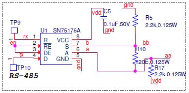

i have observed the issue in the above mention part (RS485 communication IC) rx pin should be default high in the normal working but it is default in low but if i replace with new IC then it's working as expected (default high state)
and D pin is default in high state in both working and non working IC also
what is the issue in the IC for this error

  • Specification:
     input supply(Vdd): 5V,
    we are using these IC in our products and out of 5000 units we got 15 number like this issue.
    if we replace the IC with new IC in the same UNIT then it working fine as per the expected.
    refer the schematic below.
    enable (2,3) driving from MCU.
    let me know if more information required.
  • Hello Naveen,
    I believe I have found a potential solution. Using your pull-up/pull-down resistors I was able to calculate what the Vab voltage would be, it was around 0.13 V. This is inside the null region between -200 mV and 200 mV. This could be why some parts appeared to not work. I calculated the maximum resistor you need to enable to differential voltage to be 200 mV, and it is 1.4 k Ohms. I would recommend using 1k resistors to have some tolerance.
    Matt
  • Hi matt,
    Thanks for your effort to finding the issue in the pull up and pull down resistor.
    after replacing the resistor device start working as expected.
    Best Regards
