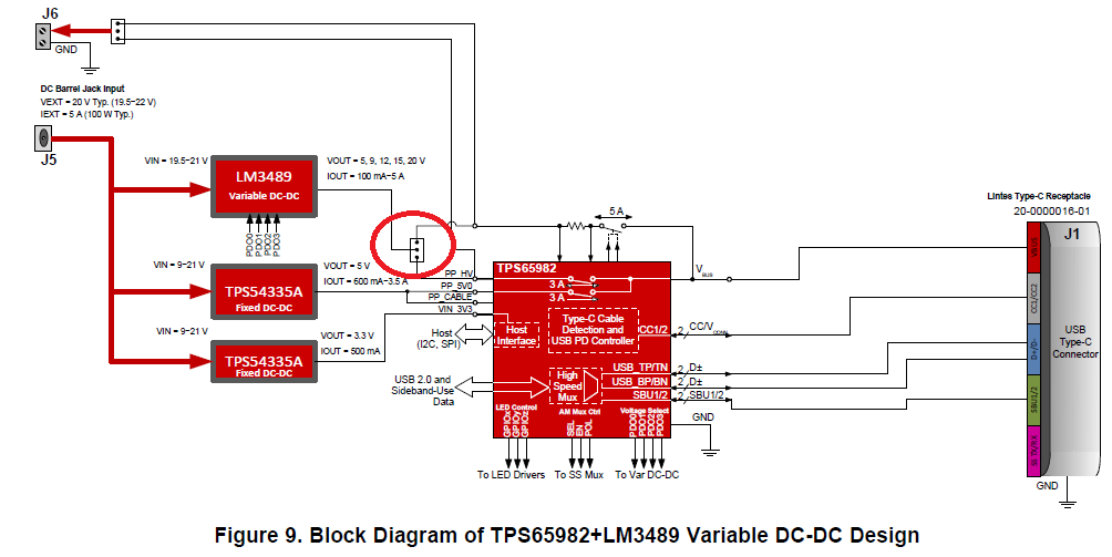

TPS65982: TPS65982 DRP power structure
Part Number: TPS65982
Dear Sir
We have a DRP requirement ,spec is power source 5V/9V/15V/20V and power sink 5V
If when this device config to UFP mode (power supply from TypeC) and than insert the power jack on J5 as below
Should I add a reverse current protection power switch as below red mark ??
Do you have the reference design or example schematic ??
