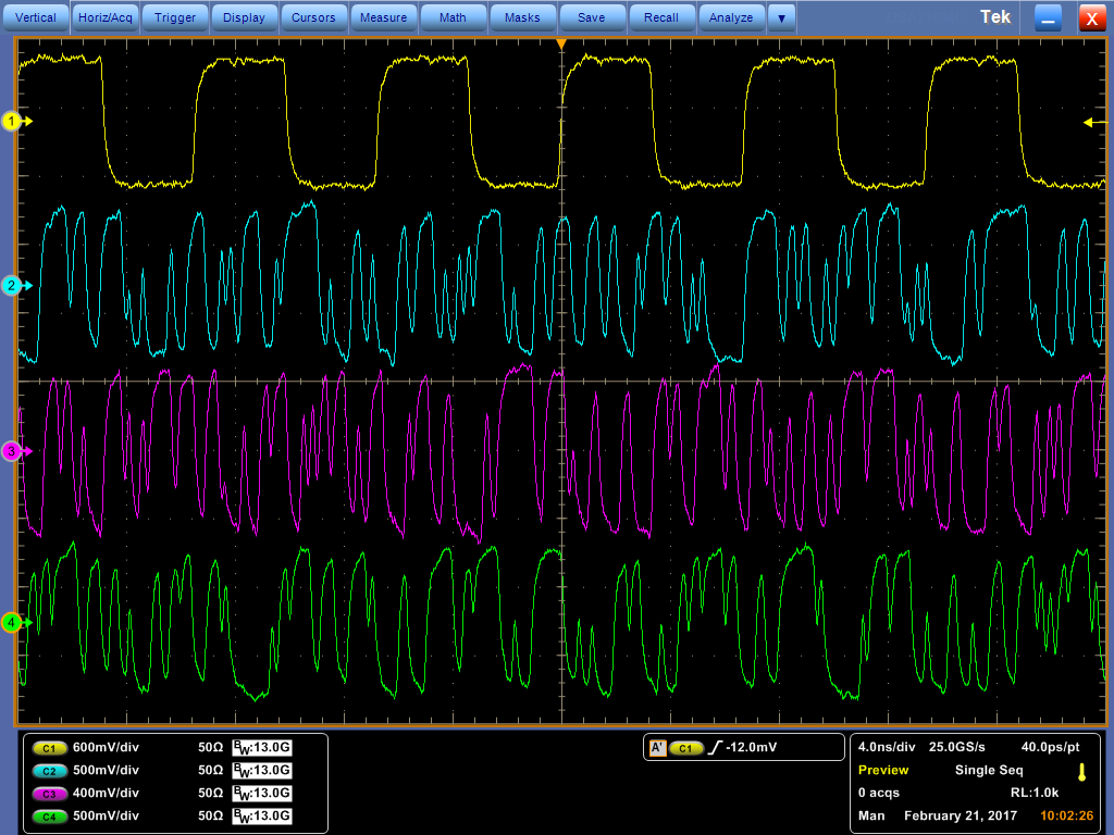

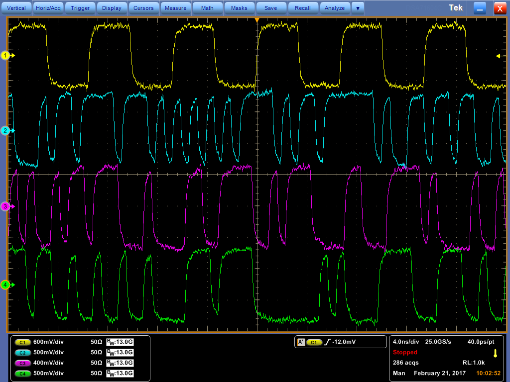

I'D like to confirm the signal detector function of the device.
When the fuction enabled,  the input signal was deteriorated and failed.
Did you detect the problem ? or need a spetioal setting ?
Input signal : 4096x2160 60p 4:4:4
EVM : TMDS181RGZ
Sequence :
 1. Power up
2. Pushed the reset button
3. SIG_EN pin : Switch to H level
4. Disconect a input HDMI cable
5. Connect a input cable again
The  wave form are as below.
4K input signal        SIG_EN:Disable
4K input signal        SIG_EN:Enable

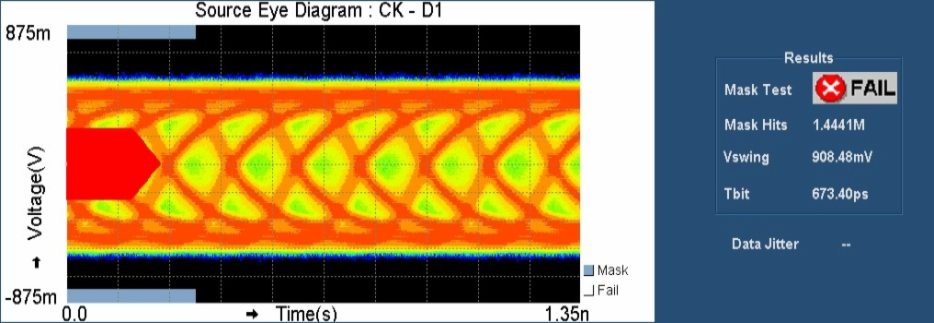

Under the signal detect circuit enabled condition, the output of the TMDS181 was failed at Eye test  as bellow.
 Please let me know a solution of the problem ?
