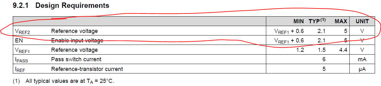

  Could PCA9306 support I2C voltage translate between 1.5V and 1.8V?
  If not,is there any device or solution can recommend to the customer?
Nick Dai
  • Hello Nick,
    Technically is should work but our datasheet specifically calls out it was tested with the following.
    We have had customers use it this way in the past but because it doesn't conform to the datasheet, therefore we can't guarantee the operation as such.
    -Francis Houde

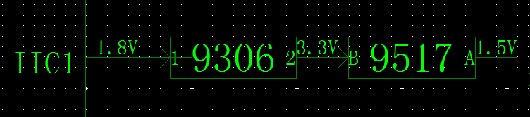

        Could the customer use PCA9306+TCA9517 to translate between 1.8V and 1.5V as below shown?
    Nick Dai
  • Hello Nick,
    Yes, the customer could do something like this. This is perfectly acceptable, though it does add cost. We have a new part coming out soon that would address this situation. We can take this offline and I can share information with you and your customers.
