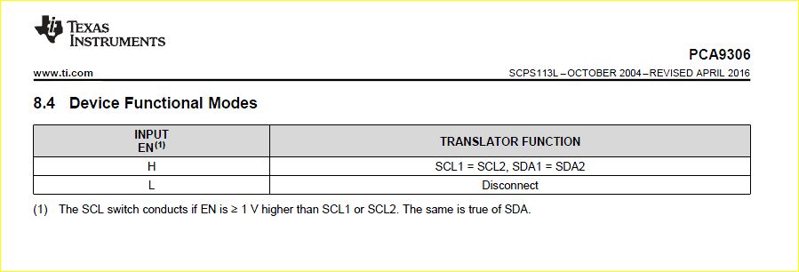

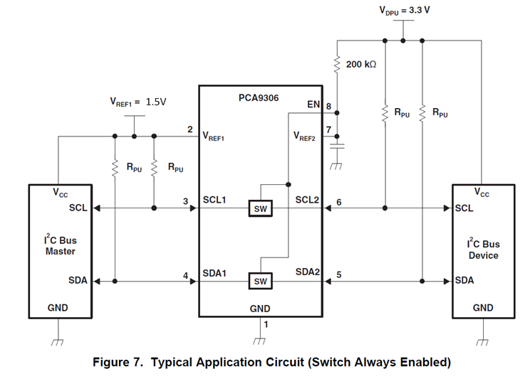

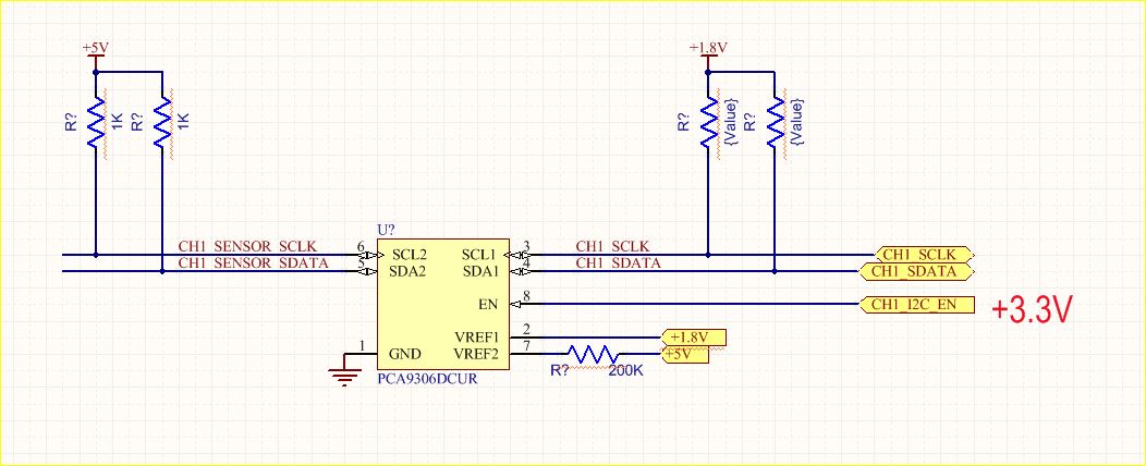

PCA9306: EN pin with 3.3V logic when VREF2 is connected to 5.5V?
Part Number: PCA9306
Is it OK to drive the EN pin with 3.3V logic when VREF2 is connected to 5.5V?
