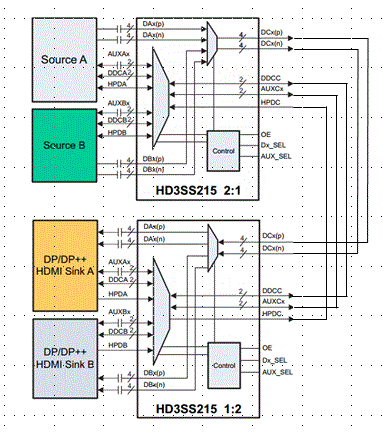

Part Number: HD3SS215
Hi all,
My customer would like to use the followimg combination,
Can they use this combination?
If they use this combination, Can the device meet the HDMI standard?
(for example, signal loss, DC loss etc...)

Hi Sho-san,
Yes, the customer can use that configuration.
To pass HDMI certification doesn't depend only on the two HD3SS215 in cascade, they have to consider connectors and trace losses.
It would be better to add a redriver like TMD181, and depending if this is a source or sink application configure it accordingly to match channel losses.
