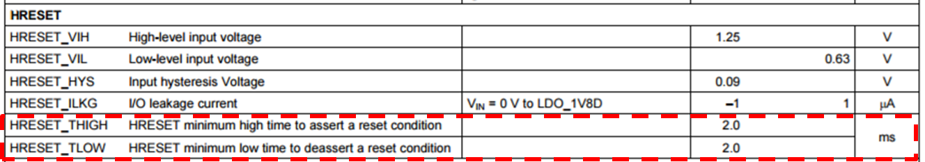

Could you tell me how long should I pull high HReset pin to reset TPS65982?
My customer need this spec to implement their EC code.
