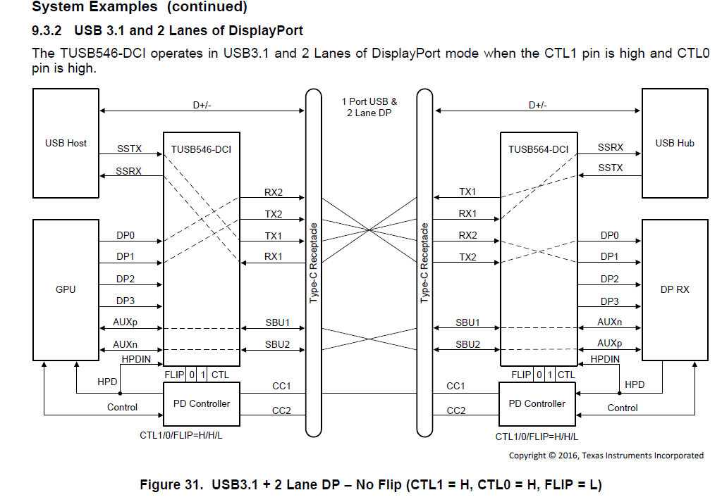

As TUSB546 datasheet says, it supports only DFP mode. Its for DP lanes alone or both USB as well as DP lanes?
In our case, we want Dual Role Data(DRD) for USB and DFP for Display port.  can I use this IC (TUSB546)?? In datasheet, the functional block diagram shows USB lines has Redriver circuit in both upstream and downstream side. there the confusion starts.
One more query is ,the below image which we have taken from TUSB546-DCI datasheet has TUSB564-DCI chip used at SINK side (UFP) but we didn't get any information in TI website with respect to that chip.

    The case you are interested is correct. You can use the TUSB546 as Dual role for USB, as long as you are capable to switch the SSTX/SSRX lines between a Host or a device (some customers switch the USB path between upstreamport and downstreamport from a USB HUB). But the DP lines aro only for Sourcing DisplayPort video. Regarding the TUSB564, the device hasn't been released yet, that's why you can't find more about it on our website.
