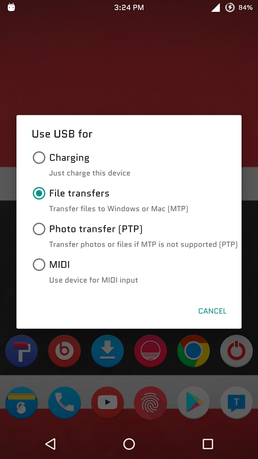

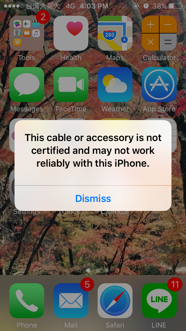

Part Number: TPS2546
Team,
I am using TPS2546 as USB controller.
when I insert a USB cable, there will pop-up a massage like following.
Do you have any idea that I can set anything not to shoe this message??
Marco
Hi Marco,
what's your using case ? do you need data + power or you just need to provide power to the phones ?
if you just need to provide power to the phones, just configure the TPS2546 to DCP_AUTO mode (CTL=0, CTL2=CTL3=ILIM_SEL=1).
