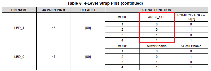

I found ANEG_SEL (Auto-Negotiation Select) in strap configuration.
Is the configuration for ANEG_SEL no effect under Autoneg Disable=1 (MODE 4)?

Hello Yaita-san,
The strap on RX_CTRl is used for enabling or disabling auto-negotiation. If auto-negotiation is enabled then ANEG_SEL strap on LED_1 is used to select which speeds will be advertised during auto-negotiation. If ANEG_SEL is 0 then all speeds, 10M/100M/100M, will be advertised. If ANEG_SEL is 1 then only 100M and 1000M will be advertised during auto-negotiations.
