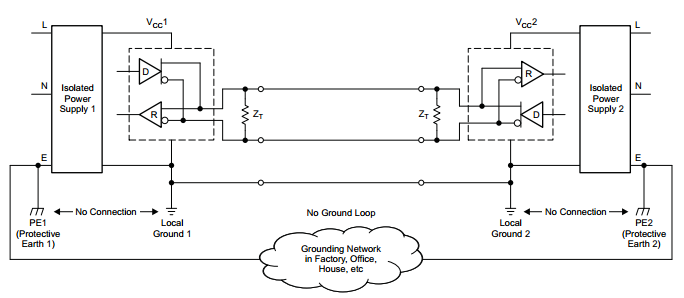

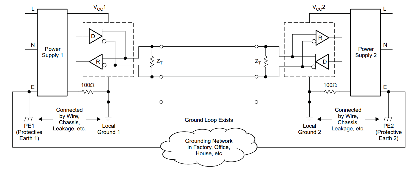

    Yes, it is possible to damage the device if it is subjected to greater than 14V. Your customer could look in to getting a part with a wider common mode range such as the SN65HVD21A with a common mode of -20 to 25, or a SN65HVD1786 if you need protection above 20V (the part will not operate above 20V but will return to normal after the common mode voltage goes down). But if ground potential difference is a big concern, you will need a ground wire of some sorts. The ground wire could be a shielding around the twisted pair tied to ground, or an actual third wire. I have attached some diagrams to help and cover some different options. Would you be able to share some schematics of your customers system?
    First off it sound like your customer has done something close to this just with out the ground wire. I feel like this might be the easiest to implement on their system
    or for non isolated power supplies. The resistors are there to limit the possible current in  the ground loop.

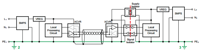

    A more difficult way is to build the system is like this. The up side to this system is that it can withstand a few kilo-volts of common mode voltage and is very robust. In this setup all but one node would need isolation.

                  If customer has used the Option3 which isolated the power supply and the signal . Do they still need the higher maximum rating of the common-mode of the
    RS-485 transceiver such as SN65HVD3082E.
                  As my logic , even isolating between the transceiver and the system , it is still possible to damage the transceiver if greater than the 14V.
  • With Option 3, the transceiver on the right uses the ground of the left device, and then translates to the possibly-different level of the actual device. This implies that there is almost no common-mode voltage and that you can use a device with a lower maximum rating, but it does not help you because it still needs a ground wire.
    All three options use three wires. (In option 3, you could omit the isolated supply by using a fourth wire to power the right transceiver from the other end.)
    Adding overvoltage protection to your circuits might be a good idea, but that just prevents the transceivers from being damaged, it does not make the communication work if the ground level difference is outside the allowed range.
    You can get away with two wires only if you ensure that the common-mode voltage is limited. If at all possible, find a third wire (or shield, or anything).

    If the customer uses option 3 they could use the SN65HVD3082E and just like Clemens said option 3 has almost no common-mode voltage so there is very little of a risk of damaging the part with different ground potentials, but requires a ground wire as with all the other system solutions.

                      I misunderstand the option3's ground connection before , and customer used the option3 without the Ground connection between two RS-485 transceiver,
    just isolated the power and signal between transceiver and the internal system.
