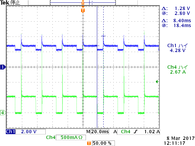

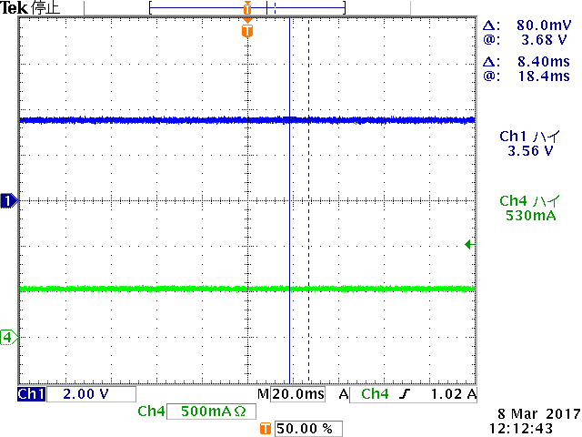

(2)
About the waveform of output voltage and output current.
The range of drooping characteristic: Output voltage is 3.5V.
(Ch1: Output voltage,  Ch4: Output current)
It is the expected output without oscillations.
However, the range of the characteristic of 'フ': Output voltage is 2.5V.
Output voltage and output current have cyclic behavior.
There are overshoots, too.
※Please teach him the reason about these behavior.
Dice-K
  • The behavior observed may be related to the use of an electronic load. If possible, retry using a resistive load (maybe use a decade box or some other variable power resistor). The E-Load may not be able to regulate current (CC mode) when the output voltage goes below the spec of the E-Load.
    For the oscillation, at first it appeared to be thermal cycling (TPS2553 has built in thermal shutdown) but the output voltage is not going to ground (power switch turns off) when the current goes to zero. Make sure your input supply is not oscillating or drooping and causing the measurement above.
