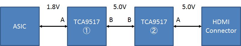

    Please let me ask again to use TCA9517 for HDMI DDC. My customer is considering to use two pcs of TCA9517 to translate from 1.8V to 5V for HDMI DDC. Can you recommend to use with following configuration?
    Satoshi / Japan Disty

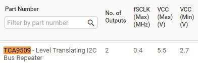

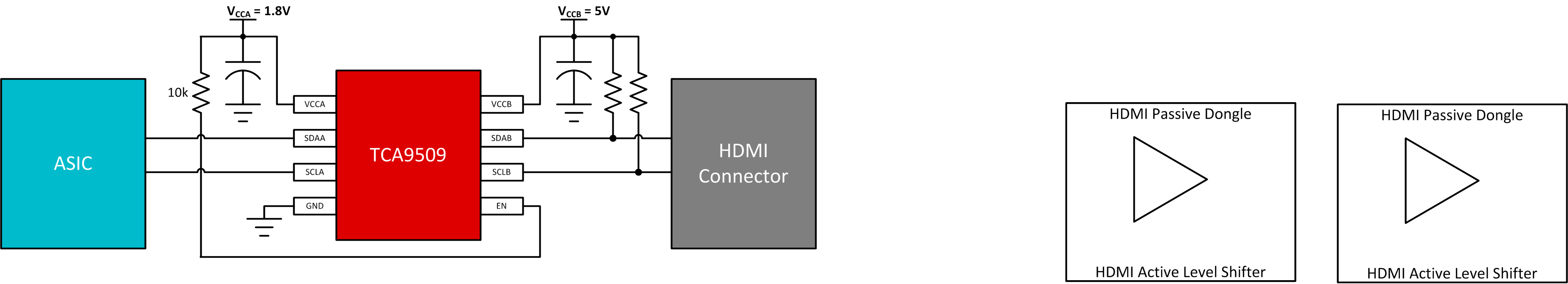

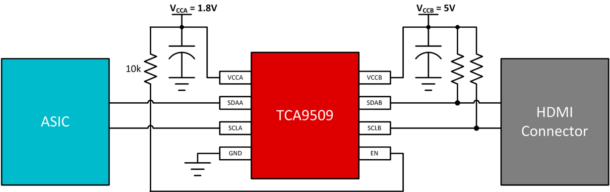

    Have you considered using the TCA9509.  I have attached a reference diagram for your application.  This should work find.  The buffer on this part is on the A side, therefore it will not interact with the capacitance testing for the B side.
  • Hi Francis,
    Thank you for recommending TCA9509. I'll introduce it and discuss with customer.
    Just to tell you, I can't find TCA9509 to meet my requirement because its minimum VCC is 2.7V in selection table in TI.com. I hope you to consider to show min/max for both VCCA and VCCB.
