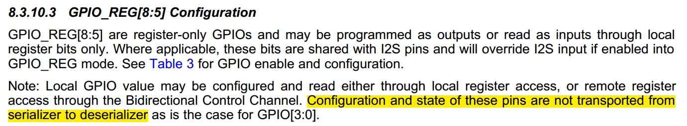

I have some problems about DS90UB947-Q1, please help to give out your insight about it:
  • Why the configuration and state of GPIO5_8 could not transferred from ser to deser, as it could configure and read through local register access or remote register access through BCC.

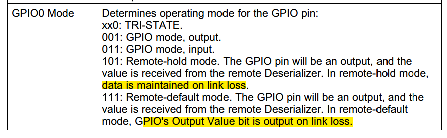

  • What is the meaning about GPIO’s output value bit is output on link loss, as the statement in below screenshot?

  • Hi Fery,
    The configuration state of GPIO5_8 cannot be transferred from SER to DES because of the device muxing limitation. If this feature is necessary please use GPIO0_3.

    GPIO's Output Value bit is output on link loss means that if Lock is lost between SER and DES the gpio will still retain the last programmed value and will continue to assert it accordingly.
