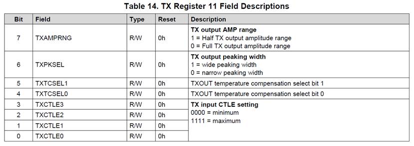

I have some other questions about thermal compensation in ONET1130EC. This part is not fully described, so there are no clear understanding.
As you can see there are 2 bits TXTCSELx present in register 11 corresponded for thermal compensation.
But there are no description about available values and influence on ONET1130EC.
So can you clarify next questions:
  1. It’s correct that it’s temperature compensation of modulation signal amplitude?
  2. How compensation mechanism are implemented? It’s just additional coefficients or something another?
  3. What are combinations of bits can be set and what does they means?

  • Hi Vladimir,
    Sorry for the delay in response. Here are my responses to your questions on the thermal compensation:
    Response: Yes, the TXTCSEL[1:0] bits of the Register 11 control how well the signal amplitude is maintained by compensating for the temperature dependent variations in the amplitude.
    Response: Temperature compensation is implemented through a feedback loop inside the gain stages of the driver, by controlling the coefficients that define the extent of constant gain or constant amplitude of the output signal.
    Response: There are 4 levels of temperature compensation feature that can be applied to the signal, through the TXTCSEL[1:0] bits of Register 11. Unfortunately we do not have the exact quantification of what the individual levels mean at a systems level, but setting the TXTCSEL[1:0] to 2'b11 will apply the highest temperature compensation to the signal. The default value for these select bits TXTCSEL[1:0] is however 2'b00, which applies a moderate compensation. Please note that setting the select bits TXTCSEL[1:0] to 2'b01 results in the least compensation.
    Hope that helps.
    Sri
  • Hi Vladimir,
    Correction in my reply to your last question above:
    "Unfortunately we do not have the exact quantification of what the individual levels mean at a systems level, but setting the TXTCSEL[1:0] to 2'b11 will apply the lowest temperature compensation to the signal. The default value for these select bits TXTCSEL[1:0] is 2'b00, which applies a moderate compensation. Setting the select bits TXTCSEL[1:0] to 2'b01 results in the highest compensation."
    Sri
