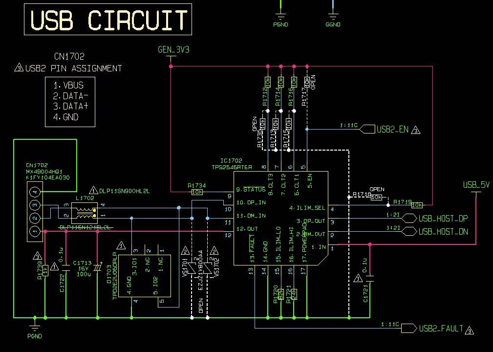

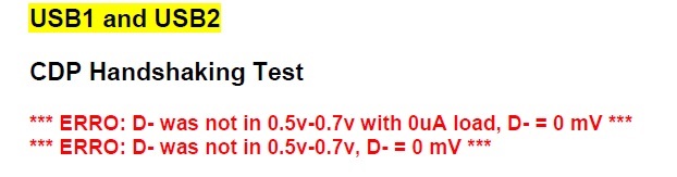

Hi Support team.
My customer have used TPS2546 and designed CDP mode (1111). They did USB certification and found a failed massage in BC 1.2 CDP handshaking test.
Per my understanding, it’s a known issue, may I have your comment or suggestion? Thanks for your help and time.
