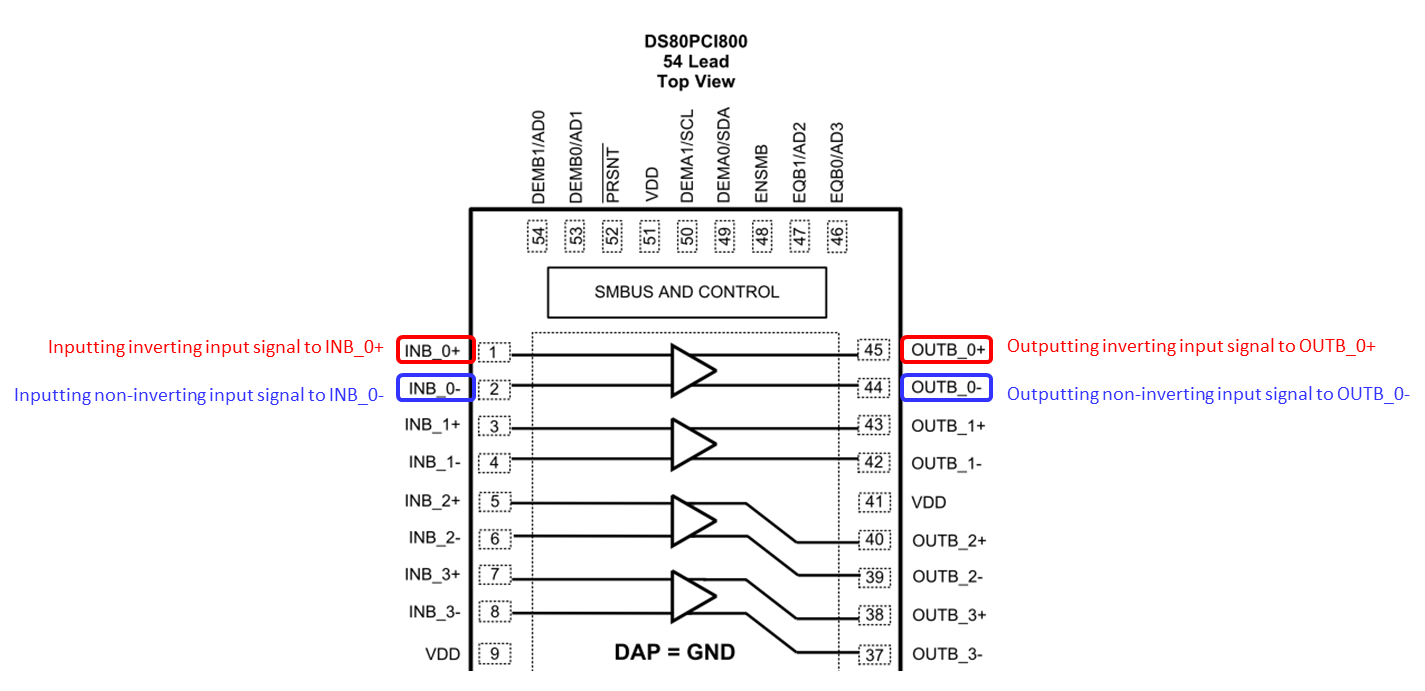

Part Number: DS80PCI800
I believe that DS80PCI800 works normally if the polarity of the input signal is swapped as below but would like you to confirm just in case.

Hi Kato,
Yes swapping the inputs and outputs is no problem. In many cases this will improve the board routing.
