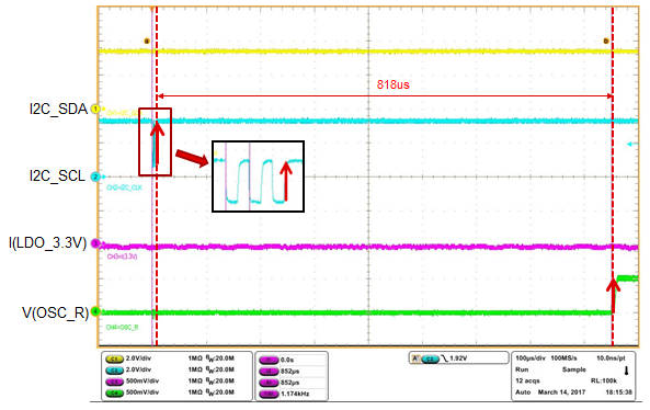

As for "I2CBus Activity", ...
According to my evaluation, the rising edge of SCL three times at least is to exit from SLEEP mode. SDA doesn't relate.
Why is the rising edge needed three time?

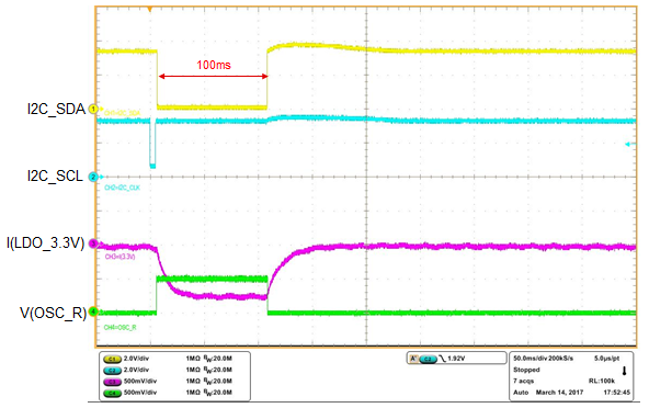

When I evaluated, I observed the phenomen that SDA was LOW for 100ms when 982 exited from SLEEP mode
Why did SDA become LOW?

    Ans-2/1: Why three cycles exactly is something that I need to check, but in general, the device shall account for unwarranted transitions on the line (that could result in false triggers) before treating it as a valid transaction, and therefore the additional cycles. Can I understand the customer's concern here?

    Ans-3: I'll check internally on why the SDA is held low, but 100ms is the activity timeout, and if no activity is seen for this time, the device will return to sleep state.
