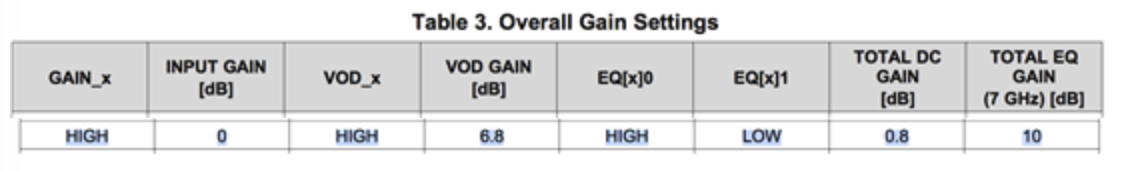

Dear All:
Please help to check below issues with SN65LVCP114:
we have used this device as a 100Mbps ethernet port switch, The system structure shown below:
100Mbps Ethernet Signal - > | AINP0(pin) AINN0(pin) ------(SN65LVCP114) ----COUTP0(pin) COUTN0(pin) | ---> Ethernet Transformer
1: our input signal to SN65LVCP114 as below:
 input signal Rise Time = 3.708ns   (3ns <= Rise Time <= 5ns)
 input signal Fall Time = 4.088ns   (3ns <= Fall Time <= 5ns)
2: our out signal from SN65LVCP114 as below:
Rise Time = 1.324ns   (3ns <= Rise Time <= 5ns)
Fall Time = 4.925ns    (3ns <= Fall Time <= 5ns)
3: Our device has config by I/O set which shown below:
After we check the output signal, We find the rise time of output has bing reduced(3.078 ns to 1.324 ns) by SN65LVCP114 and fall time of output has bing pulled longer (4.088 ns to 4.925 ns), It cased our 100Mbps communication loss data packages , So we know to get a recommend SN65LVCP114 config data for 100Mbps application from e2e.ti.com, So please help to check this issues!!
